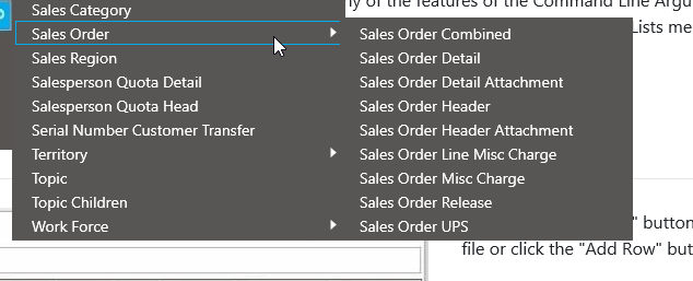

Here’s part of the Sales menu
You see that you could use DMT on just the “Sales Order Header”, or “Sales Order Combined” In the combined DMT “object”, you’ll usually see fields with a # in them. This is used when you need to specify the table you’re trying to affect.
The Sales Order Header object has a field OrderNum. So do each of the Sales Order Line and Sales Order Release objects. But the Sales Order Combined needs to specify the OrederNum for each of those tables, so you end up with fields:
