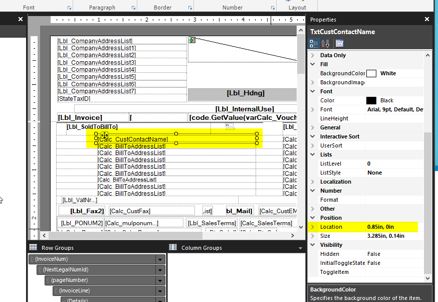

And there’s always SSRS’s Report Builder. Select the object, and the position is shown in the properties pane. Here I selected the TxtCustContactName textbox in the design area, and can edit the position in the properties.
Note that this is relative to the object it is in. The screen shot shows it having a left value of 0.85 in. This is not relative to the edge of the page, but rather the container it is in (which is in Rectangle4, which is in Tablix1, which is in the Body of the report.). Rectangle 4 has a left value of 0, Tablix1 is 0.1175 in. The Body is always at the Left margin of the report. In my case the left margin is 0.25. So that filed should be (0.25 + 0.1175 + 0.0 + 0.85) in from the left edge of the page.
