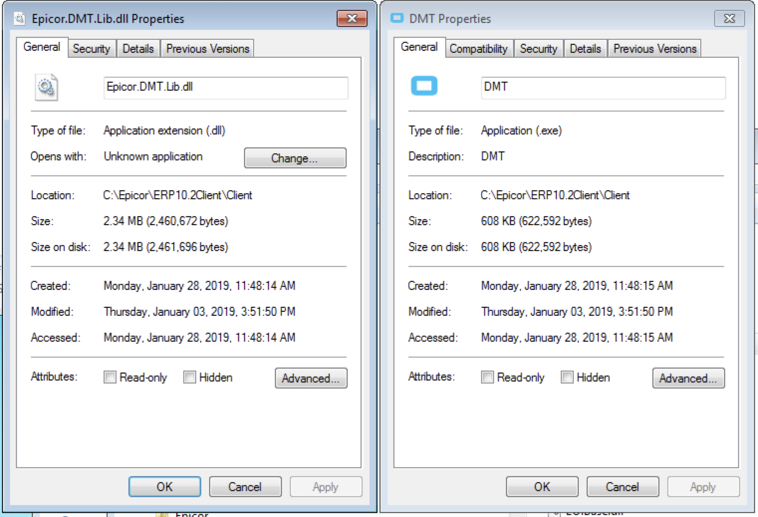

Can you right click on DMT.exe as well as Epicor.DMT.Lib and make sure the DLL’s aren’t locked for security?
Not sure what you mean… if I right click in Windows Explorer I get a pop-up menu, but nothing mentioning locking. I am able to (temporarily, for testing purposes) rename both files which my understanding is shouldn’t be possible if a file is locked.
Also, the second file appears to be Epicor.DMT.Lib.dll, not Epicor.DMT.Lib…

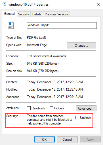

When you look at the properties of the file if it is blocked by Windows it will look like
I beleive that is what Mr @josecgomez was referring to.
I don’t see this “Security” section on either DMT related file:
Once it is unblocked the dialog reverts to its oriignal state.
