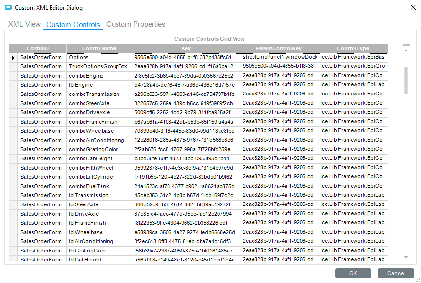

In the customized form, go to Tools > Custom XML Editor. It gives a grid you can “Copy to Excel” (you know, right-click it, like any grid in Epicor).
