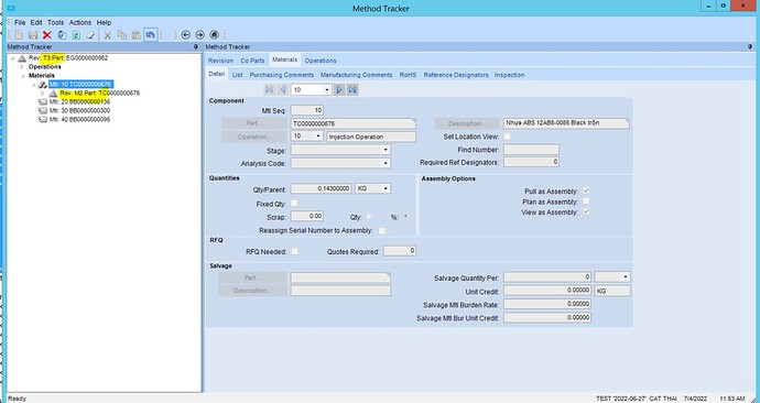

How to get RevisionNum of MtlPartNum when assigned as PullAsAsm when RevisionNum of MtlPartNum will be different from PartNum by BAQ
I want to build BAQ to extract BOM according to Horizontal

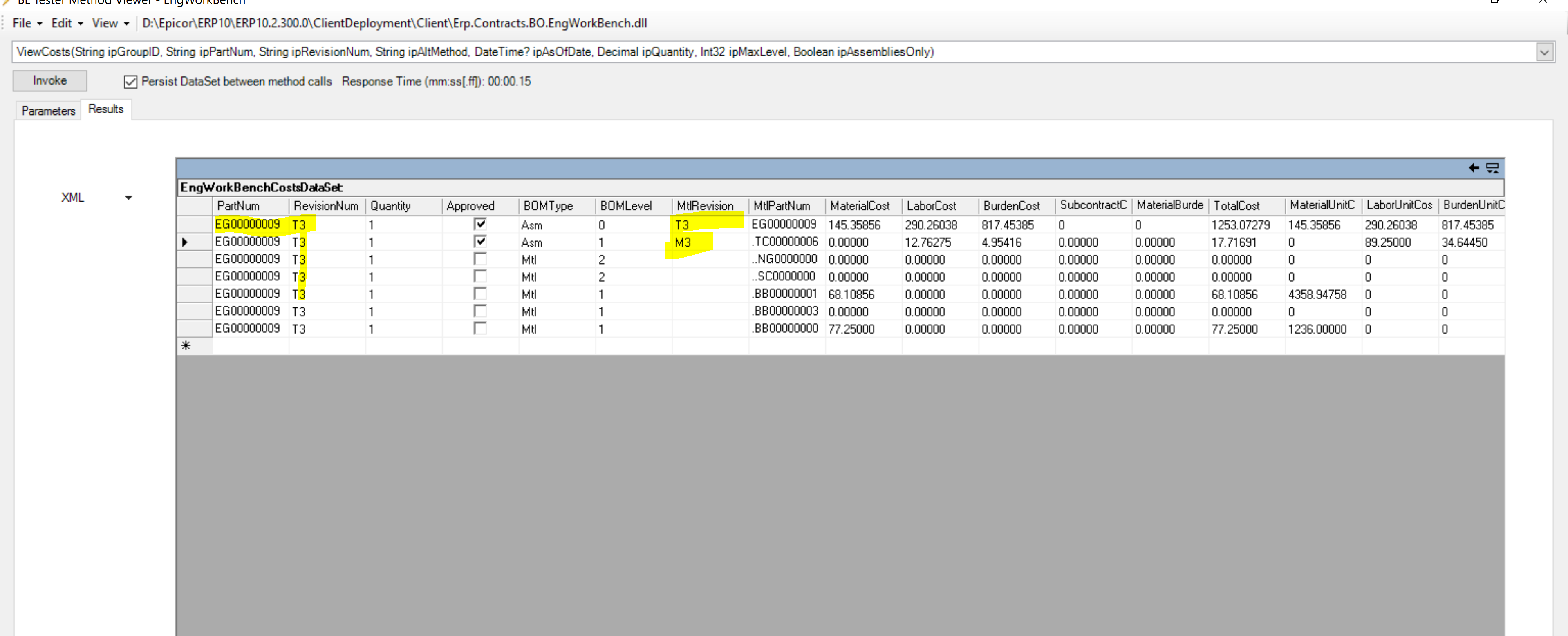

now it is possible to get the original BOM level 0 which needs further decay of the MtlPartNum lines marked as PullAsAsm or ViewAsAsm but is there a case where the RevisionNum of MtlPartNum is different from the RevisionNum of the PartNum? So how can I get the RevisionNum of MtlPartNum like in the ViewCosts method of Erp.Proxy.BO.EngWorkBenchImpl

<PartRevCostsDetail>
<PartNum>EG0000000962</PartNum>
<RevisionNum>T3</RevisionNum>
<Quantity>1</Quantity>
<Approved>true</Approved>
<BOMType>Asm</BOMType>
<BOMLevel>1</BOMLevel>
<MtlRevision>M3</MtlRevision>
<MtlPartNum>.TC0000000676</MtlPartNum>
<MaterialCost>0.00000</MaterialCost>
<LaborCost>12.76275</LaborCost>
<BurdenCost>4.95416</BurdenCost>
<SubcontractCost>0.00000</SubcontractCost>
<MaterialBurdenCost>0.00000</MaterialBurdenCost>
<TotalCost>17.71691</TotalCost>
<MaterialUnitCost>0</MaterialUnitCost>
<LaborUnitCost>89.25000</LaborUnitCost>
<BurdenUnitCost>34.64450</BurdenUnitCost>
<SubcontractUnitCost>0</SubcontractUnitCost>
<MaterialBurdenUnitCost>0</MaterialBurdenUnitCost>
<TotalUnitCost>123.89450</TotalUnitCost>
<QtyPer>0.14300000</QtyPer>
<RequiredQty>0.14300000</RequiredQty>
<PartDescription>Nhựa ABS 12AB8-0085 Black trộn</PartDescription>
<EffectiveDate>2022-07-04T11:10:32.5106295+07:00</EffectiveDate>
<BomSequence>1</BomSequence>
<Company>01</Company>
<AltMethod/>
<SysRowID>fc0bbbc1-e485-42f0-8e65-af4abf4e92cf</SysRowID>
<RowMod>A</RowMod>

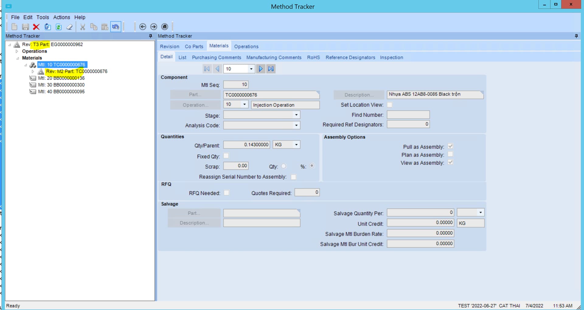

here partNum EG0000000962 uses RevisionNum as T3 but MtlPartNum TC0000000676 uses MtlRevision as M3? How can I get information from any table?
