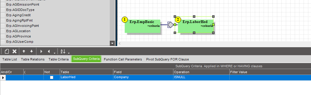

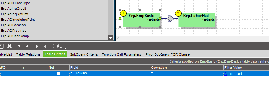

You could try doing an outer join on EmpBasic and LaborHed, then filter for records that don’t have any fields from the LaborHed table:

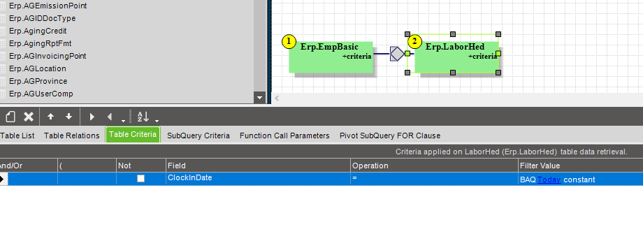

Adam, Awesome! Thank you so much! it worked perfect. Earlier I was not using the subquery - “@Today
I did @ Today in the table criteria of LaborHed.

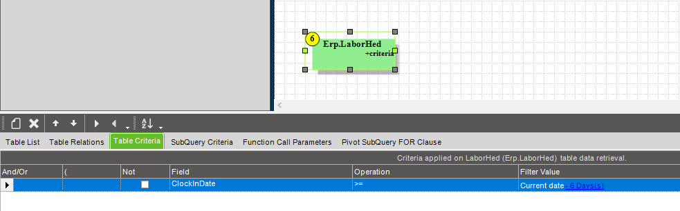

They are requesting to have the not clocked in data for a week. Because every Friday, they want to update the details who did not clocked in. But I am not finding the option week in the subquery.
Subha
Good deal! There’s another filter option you could try, its current date + or - a number of days.

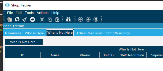

Appreciate your update Brandon! Yep I had a look at the shop tracked and tried who is not here, its works great but when I went to the system BAQ of the who is not here, its working different, the result shows only the clocked in operators.

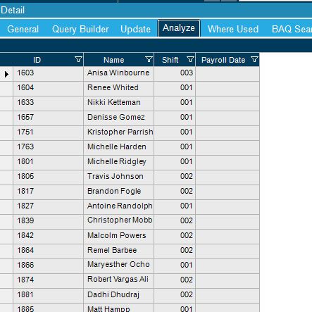

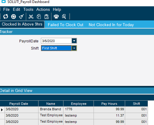

I am creating a dashboard like below but looking for a weeks data - for “Not clocked in”
Also I have to do an Updatable dashboard for “Not Clocked in” - like you said, the HR will update the weekends, vacation and holidays details against each operator. Very hard :frowning: Trying it step by step.

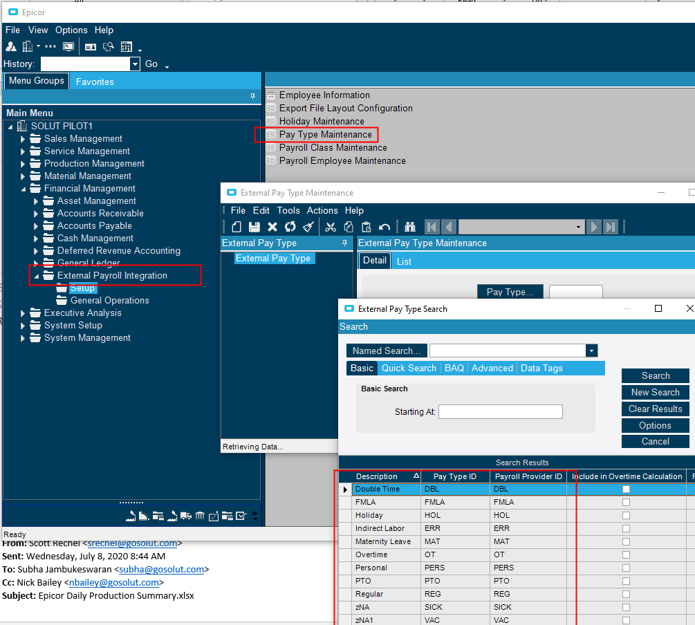

Appreciate your input Brandon, but we got the payroll module and instead of linking to UD table, I have to create an updatable dashboard linking to pay type maintenance table. So from the dashboard the HR should be able to update the reason for not clocked in for each employee. If you have any suitable updatable dashboard document, kindly share with me.
