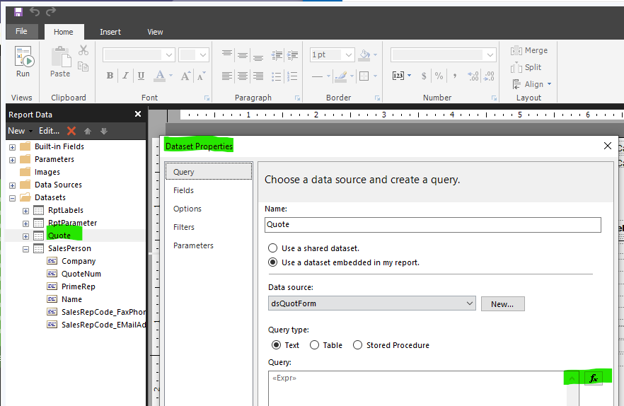

How to get the same name of field from different dataset?
My Report Builder SSRS problem is I want to use Name in ship to table, but there is Name of Salesperson in Quote dataset already. Do I have to do manual query or can I modify things in data definition? I already added table ShipTo to data definition, The other fields come out but the Name not.
I’m new to Epicor, Thank you

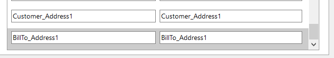

In the SSRS query dataset you should be able give your fields aliases so you can uniquely identify the fields in your report. So if you had the Address1 field from Customer and the Address1 field from CustomerBillTo, they could be differentiated like so
SELECT T1.Address1 as Customer_Address1, T2.Address1 as BillTo_Address1
FROM Customer_" + Parameters!TableGuid.Value + " T1
INNER JOIN CustomerBillTo_" + Parameters!TableGuid.Value + " T2
In your dataset fields you reference them by the alias
