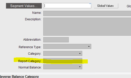

But I do not have a dropdown list of report category, it is a text box… Can someone show me with some snapshots how to set it up?

I don’t see a drop down either.

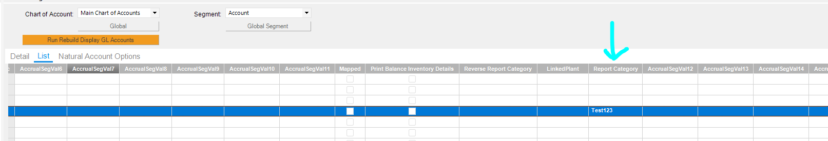

DMT Shows this on Account Segment Values

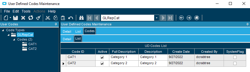

So maybe setting up a UD code of GLRepCat is what you are looking for?
EDIT:
I tried this:
and got this:
I sent this request to our CAM… Will let you know… I am surprised your description indicates the use of UDcodes…

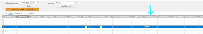

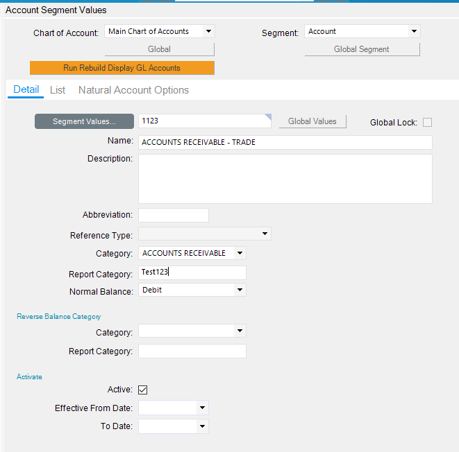

I’ve never looked at this; ours are blank. But I tried it and it does show in the grid if you want to paste update or something.

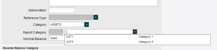

Oh, I see that now. It can be free text OR a dropdown. That’s wild. No extended property change needed, I guess?
Sorry I just saw your full entry here… Humm I find this so weird to have to rely on UDcodes for this… instead of a setup form…
So this confirms me the table name-field is COASegValues.ReportCategory.

No, the form (under developer mode) has the combo box hidden. I believe if the UD Codes are detected it shows that control. If it’s not there then it stays hidden and the text box is expanded for free text entry.
