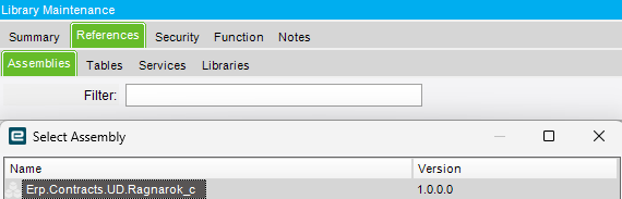

From Functions side, you need to add a reference to the assembly:
Then, you use it like this:
