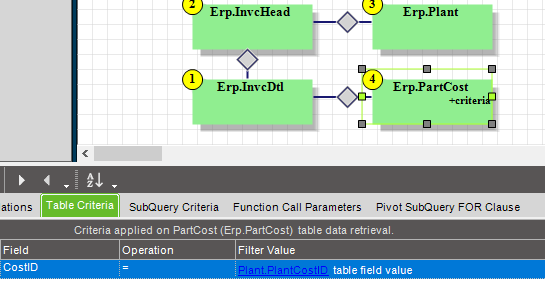

I haven’t checked the indexes for performance, and haven’t thought through if this is the best thing to do, but it will get you the data. You can join InvcDtl to InvcHead, then InvcHead to Plant. Then when you join InvcDtl to PartCost on Company and PartNum, you can add a criteria to PartCost that specifies CostID = Plant.PlantCostID.
