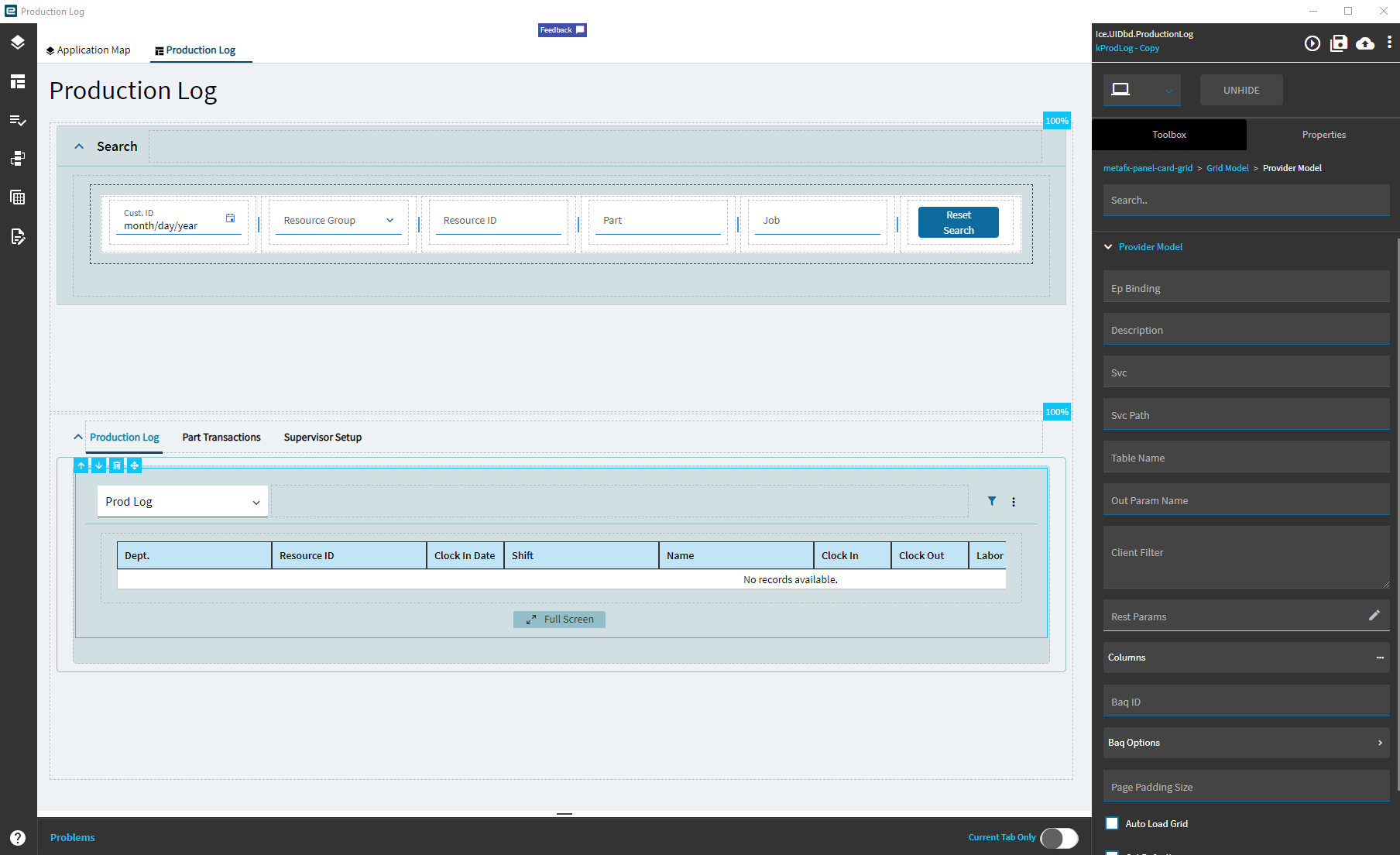

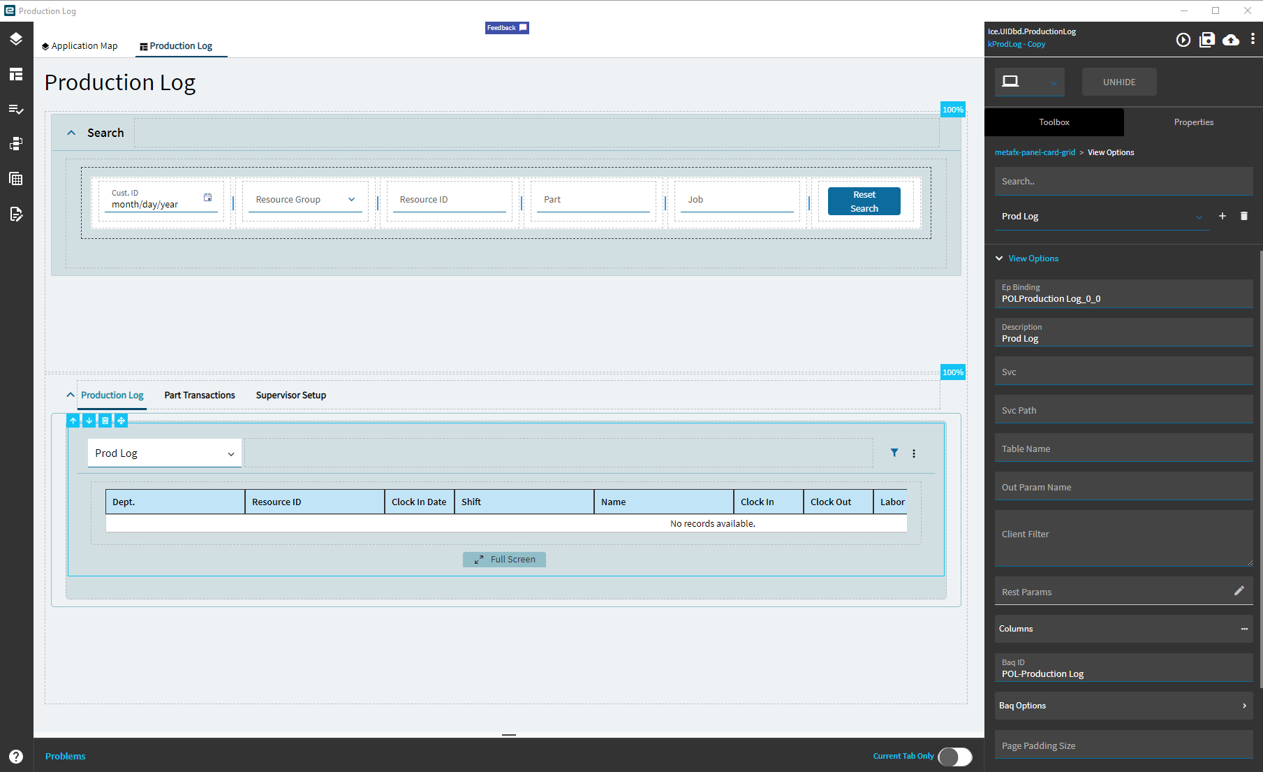

Hello guys,
Would anyone be able to help me with this piece of information?
I did the steps above but noticed one difference from the examples provided…
In my Grid Panel options there’s nothing in the Grid Model > Provider Model. instead, the data is in Advanced > View Options.
Is this as it should be?
I think this is preventing my search tracker to work.
Just set it up the same way in the View Options as you would in the other location. The View Options gives you this little dropdown filter where you can specify certain criteria for each.

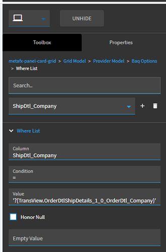

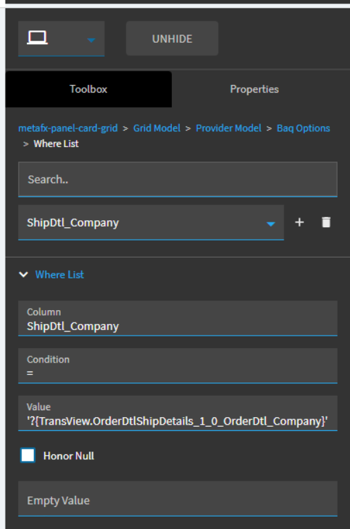

One thing that I noticed that is if I take a classic dashboard and I deploy it to a Kinetic application is that the publishing no longer works. (So far 100% fail rate on different dashboards).
The weird part is that when I go into the where list on the second grid it is referencing TransView (instead of the first grid data view).
TransView itself is blank. So I switched them to the correct data view OrderDtlShipDate_UBAQ_0_0 - still no dice. Is there an event that I have to rig?
I tested the data view by binding text boxes to fields in it, the data is showing up.
The irony is the UBAQ part is working but as the second grid is not we have to live with classic for awhile longer for this particular project.
This isn’t weird, it’s just what Epicor does by default and is annoying (IMO).
What do you mean it no longer works? The button is gone? It’s grayed out? It doesn’t do anything? I’m dumb–I get it now, lol.
Try this for the value your Where List:
'?{OrderDtlShipDetails_1_0.OrderDtl.Company}'
*Note: since you’re showing a single ? then this will only run if OrderDtlShipDetails_1_0.OrderDtl.Company has a non-null value.
That was part of it OrderDtlShipDetails is the grid I am trying to get to work so that is recursive but your idea gave me enough to go on. Thank you :slight_smile:
‘?{OrderDtlShipDate_UBAQ_0_0.OrderRel_Company}’
Did work but only once. Once I clicked another line or went back to the first line it stopped working.
