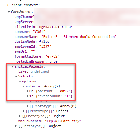

Okay, so now I’m passing the proper ID through the context, but I was getting a CustCnt not found error. But why? So, I moved it to a button click instead of OnLoad, so I can view it in Dev Tools. When I click the button, it sets Contact.PerConID to the contextValue. I look at the network call and it’s passing the correct value, but it’s still throwing an error.
I typed it in manually and compared the call and it’s sending a dataset with when you type it in manually. FFS. So now you have to set that too. Oh–an then you have to use the page-navigate-to widget to make it go to the proper page. Good lord.
