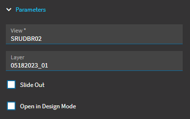

Naturally, support had no urgency to figure it out. The answer though, is really simple and I’m DEFINITELY not mad about it.

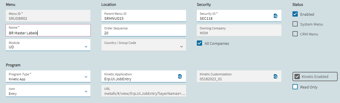

If you deploy a kinetic app as a menu item, it references the .dll which for whatever reason makes your most recently deployed menu item launch, nomatter the layer you specify in App-Open.
However, if you deploy kinetic apps and use the MenuID as the parameter for App-Open instead of the program, that launches the menu item which will have the layer you specify in Menu Maintenance.
(The “Layer” parameter isn’t even needed at this point in App-Open)
Again, not proud of how long it took to figure it out, but thought I would share for any future reference.
This should be what’s used going forward. The program DLL variation won’t work in future versions as it was discovered as a security risk. Using the MenuID honors the menu security.
You can still override the layer set in the menu by specifying the layer in the app-open widget if needed.

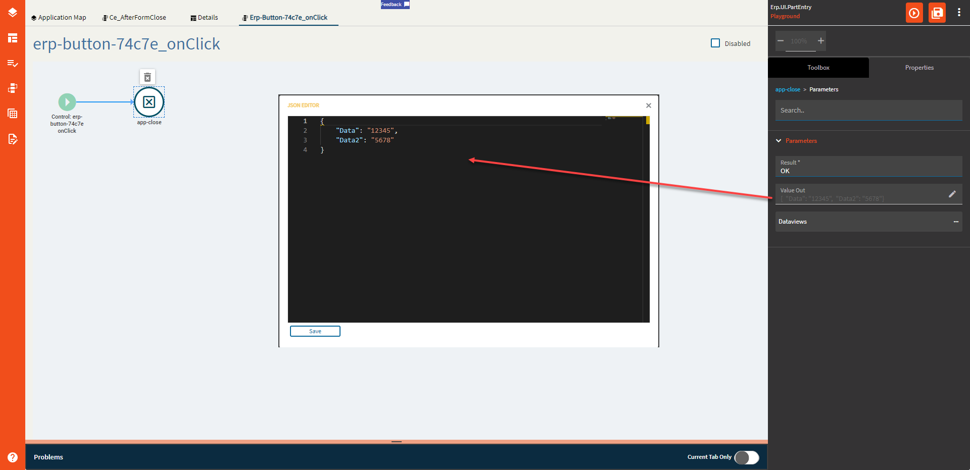

how can we load the value passing from slide out to main page? in app-close there is an option value out but not able to understand how to do it :smiling_face_with_tear:
Callbacks

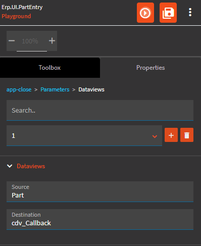

Here’s some information on how to get data back to the parent form from the called form.
In the called form, have an event that includes the app-close widget.

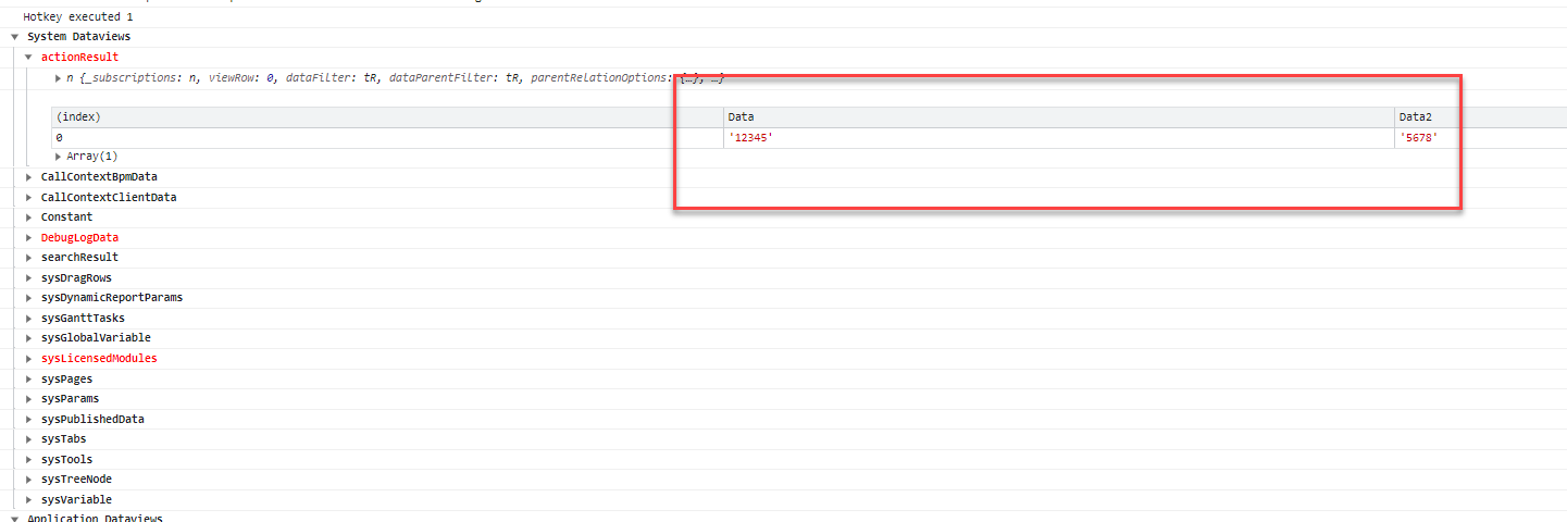

Result: This field can take any available enumerated type values: OK, Cancel, None, Abort, Retry, Ignore, Yes, No.
Value Out: This field is JSON formatted and is used to return specific values. This will get passed back to the parent form and temporarily be stored in the actionResult dataview.
DataViews: Use this to pass back an entire dataview to the parent form
  • Source: The child view’s dataview name
  • Destination: The name of the dataview in the parent form where you want the data to be copied to
Using the Value Out Data “OnOK”.
Here it is in action:
Callback

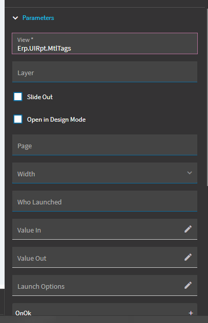

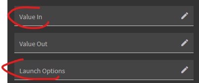

Has anyone tried to use app-open widget to start app with params in “old UI”?
I can open old app as long as I don’t put anything in the ValueIn or Launch Options fields.
This works
But If I put anything in any of these fields the app is not opening.
When I am doing it in browser it says that it cannot be opened as it is old app and it’s kind of obvious. But testing it in client does not allow to debug and I’m stuck here.
Moreover. If I want to remove these values it does not save (they are still there) so I must remove widget and add it again.
For the view–use the MenuID (Eg. SGM00021) instead of the program (Erp.UIRpt.MatlTags).
See if that lets you add values.
You will likely need to add the report to the menu to get an ID first. I usually add those under the PROCESSES folder so it’s not visually on the user menu.
The problem was with Launch Options. I needed to put all of this to get it working. It works for both Erp.UIRpt.MatlTags and MenuID in View.
	"type": "Ice.Lib.Framework.LaunchFormOptions",
	"options": {
		"whoLaunched": "Erp.UI.JobEntry",
		"valueIn": "Test"
In old UI we have something like this. The third argument is string and this is basically ValueIn.
ProcessCaller.LaunchForm(oTrans, "Erp.UIRpt.MtlTags",currVal.ToString());
For some reason the form did not open at all when I placed this string inside ValueIn field in App studio.
But when I formatted it to json syntax form has opened (but I still need only string there so that’s not the solution for me)
I think when the event starts it is checking if the ValueIn has correct json syntax and if not then it just stops without any error (just not opening the form). It is kind of strange because it doesn’t need to be json in fact. Maybe for all new Kinetic UI apps it is but definetely not for old UI.

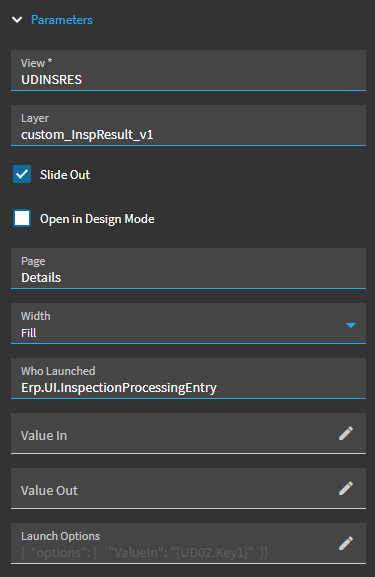

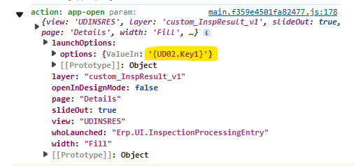

I have tried this (i believe to the letter) and i cannot get the value in to pass a data view field just the field name.
UD02 is a data view in the source application that contains data.
I must have missed something but your instructions were excellent.

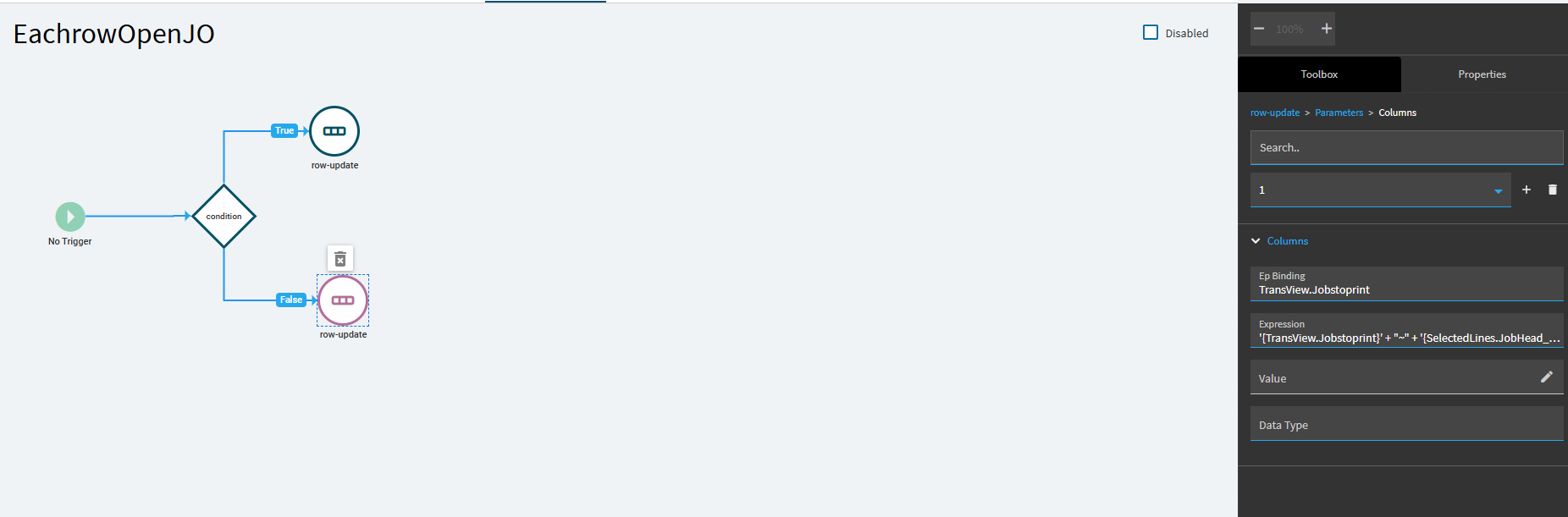

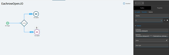

I was able to make it work as I liked. For anyone who ends up here:
  1. After enabling the selector feature on the grid and binding it to a selector column (used an updatable calculated field)…
  2. Print button action:
  3. Iterative action for the dataview condition (condition is to not add tilda before the first selection):
This problem might not be so big but took me some effort. I hope this helps someone :slight_smile:
