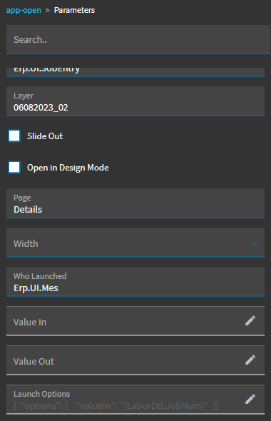

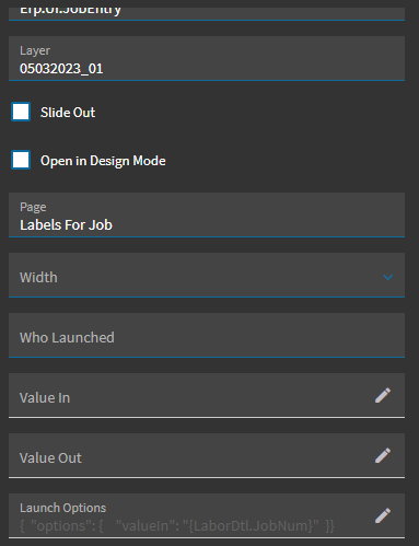

I had been able to launch a JobEntry layer from a button in MES using these parameters:

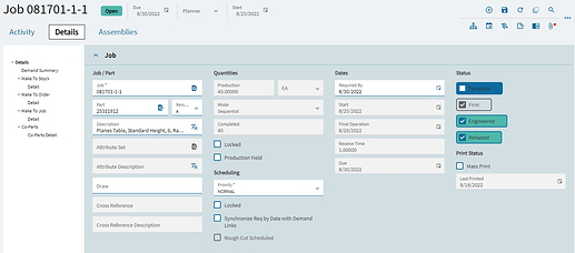

Now, the same button launches JobEntry without a layer applied. However, the launched form still navigates to the “Details” panel of the base layer.

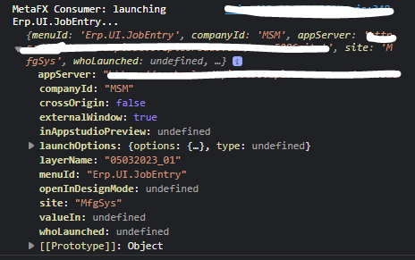

From the debug menu, it looks like the parameters have the correct layer to launch, but it somehow is not applying that. So, the issue must be within the layer itself?

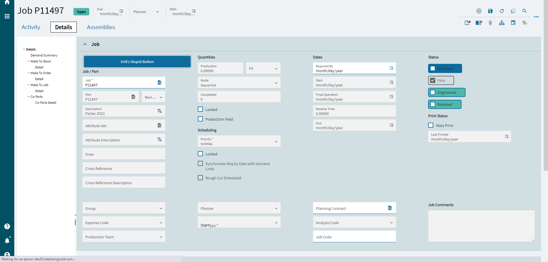

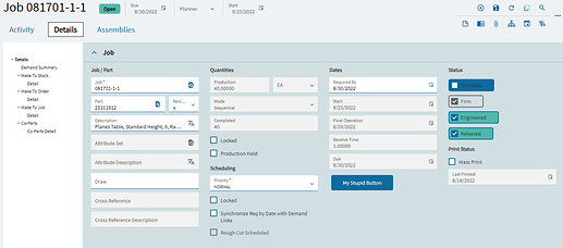

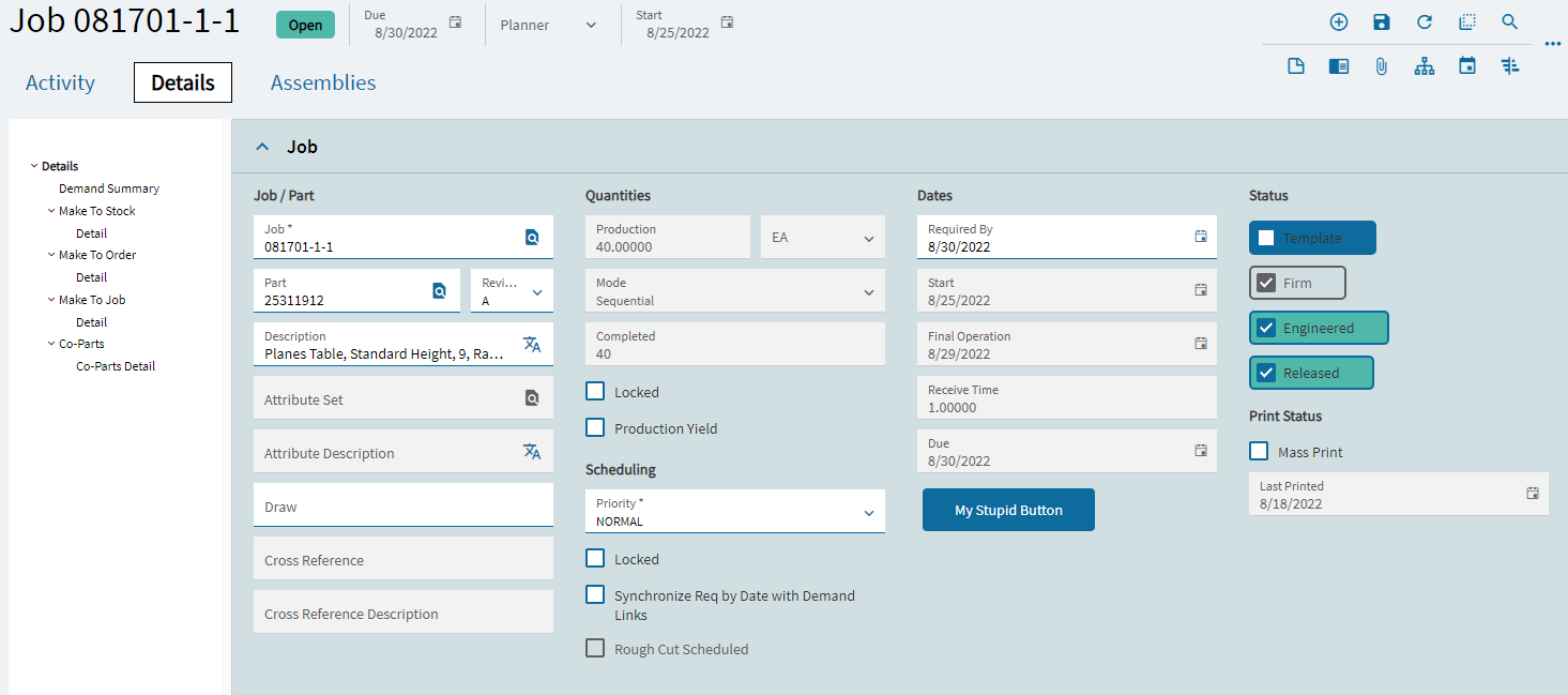

Launched from the App-Open:

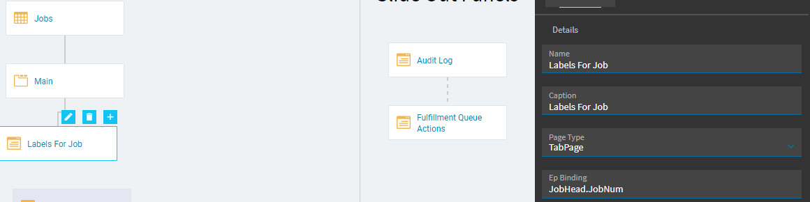

What is published to the menu:
My stupid button is nowhere to be seen.
Tabs have different names as well.
Try removing the “Who Launched”. (Not that I expect that to work, just removing variables)
Unfortunately same result,

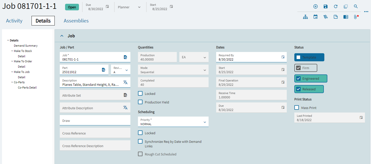

Just tried it with a fresh app-open widget and without the launch options JSON.
It hits the normal JobEntry landing page, and has no button on the details tab.
Edit: Design mode opens NewLayer Hmmmm

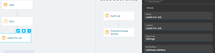

I see that all examples are opening Details page. What abt other pages?
I would like to go to “Orders” virtual page or at least “Activity” tab page in Customer Credit Manager. Mentioned app don’t want to “accept” ValueIn as a default.
So I created a Layer in Customer Credit Manager I am reading my Value on after FormLoad event. I am doing row-update and setting KeyFields.CustID to my Value. This result in Details page being open - but I can’t go neither to Activity not to Orders page. Any hint?
