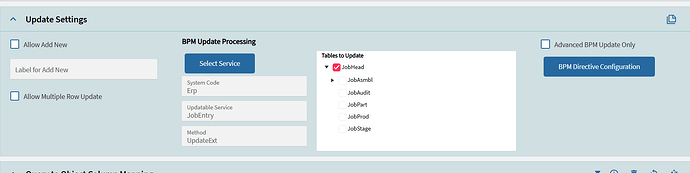

I’m having an issue with this, hoping the brain trust may have some ideas.

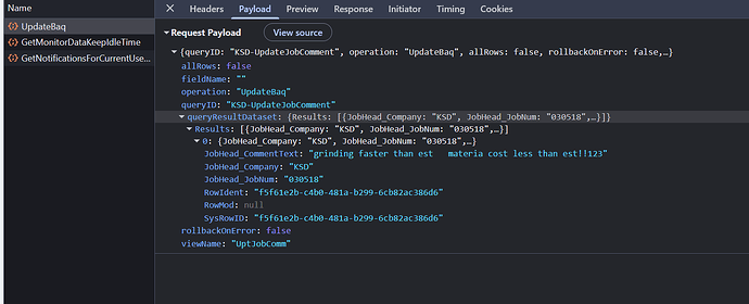

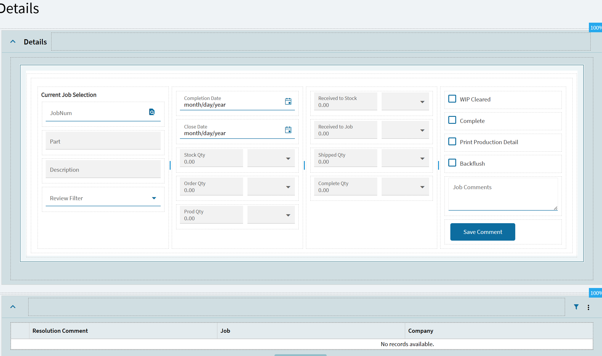

I added a grid and form entity to Job Closing for capturing a job comment on the job header (CommentText). UBAQ works fine testing in BAQ editor, it’s firing off the update BAQ just fine, and updating the view as expected. But not committing the data.
Things I’ve double Checked
  1. Tested BAQ in the editor
  2. double checked grid and column are editable
  3. Published, saved reloaded
  4. Tried trapping in F12 via chrome, the request goes out to the update function with all the pertinent fields, but returns blank.
Any ideas?

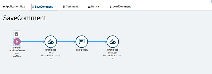

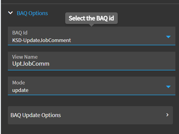

Screenshots for context

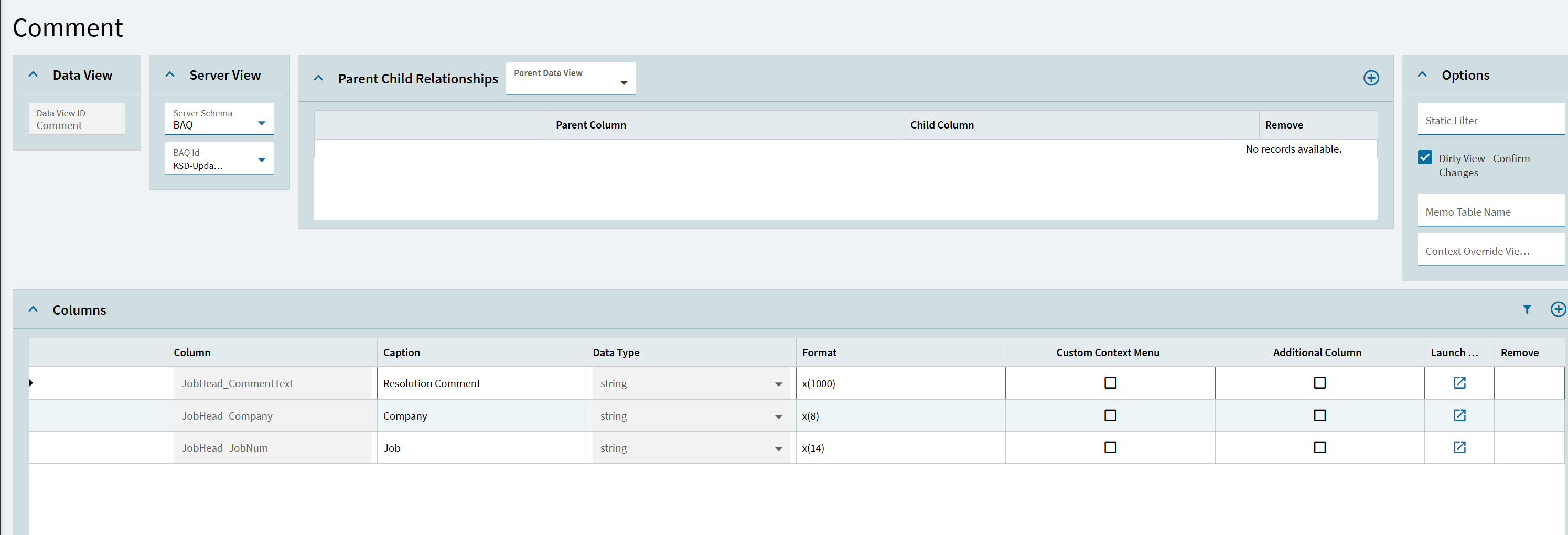

View loaded via BAQ initial get triggered after getById into View “Comment”

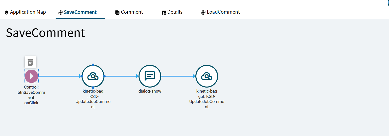

Save button action

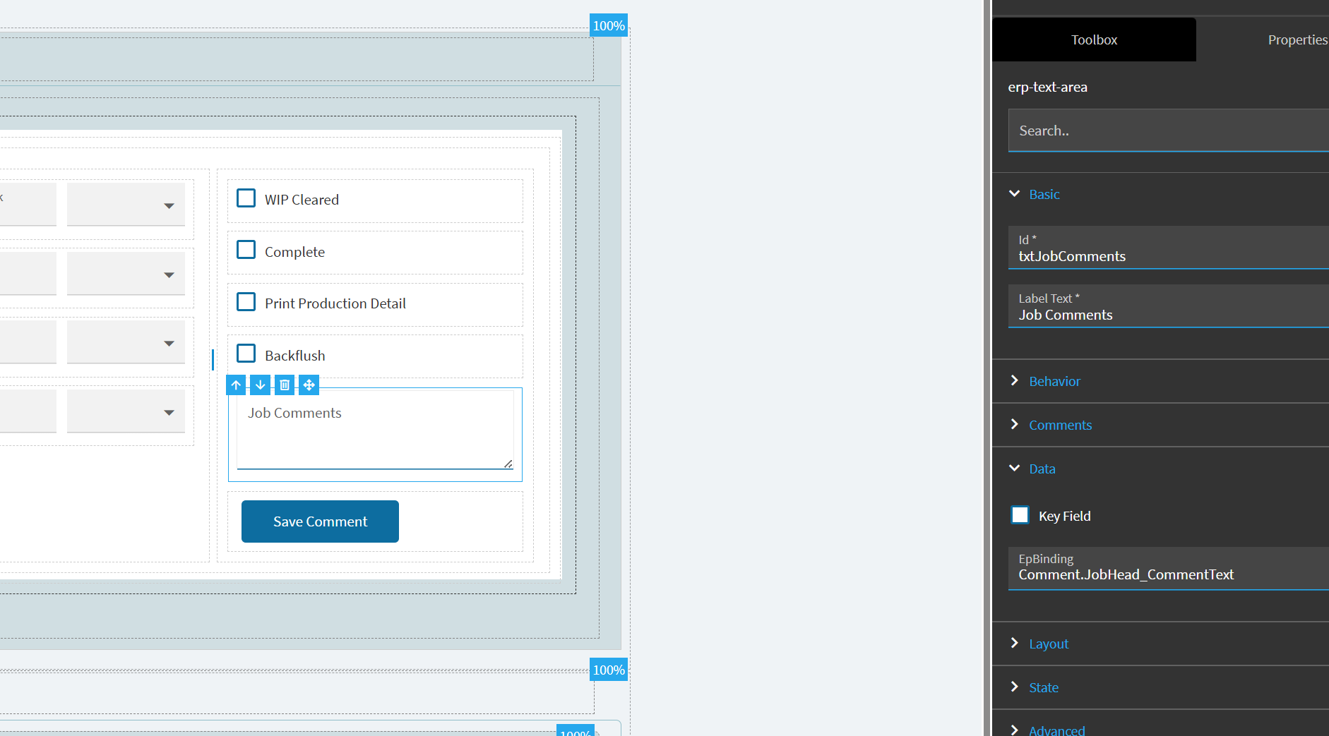

Do you have a data binding on that text field that you’ve added?
Yes, it’s bound to comment.JobHead_CommentText which is the view of the ubaq

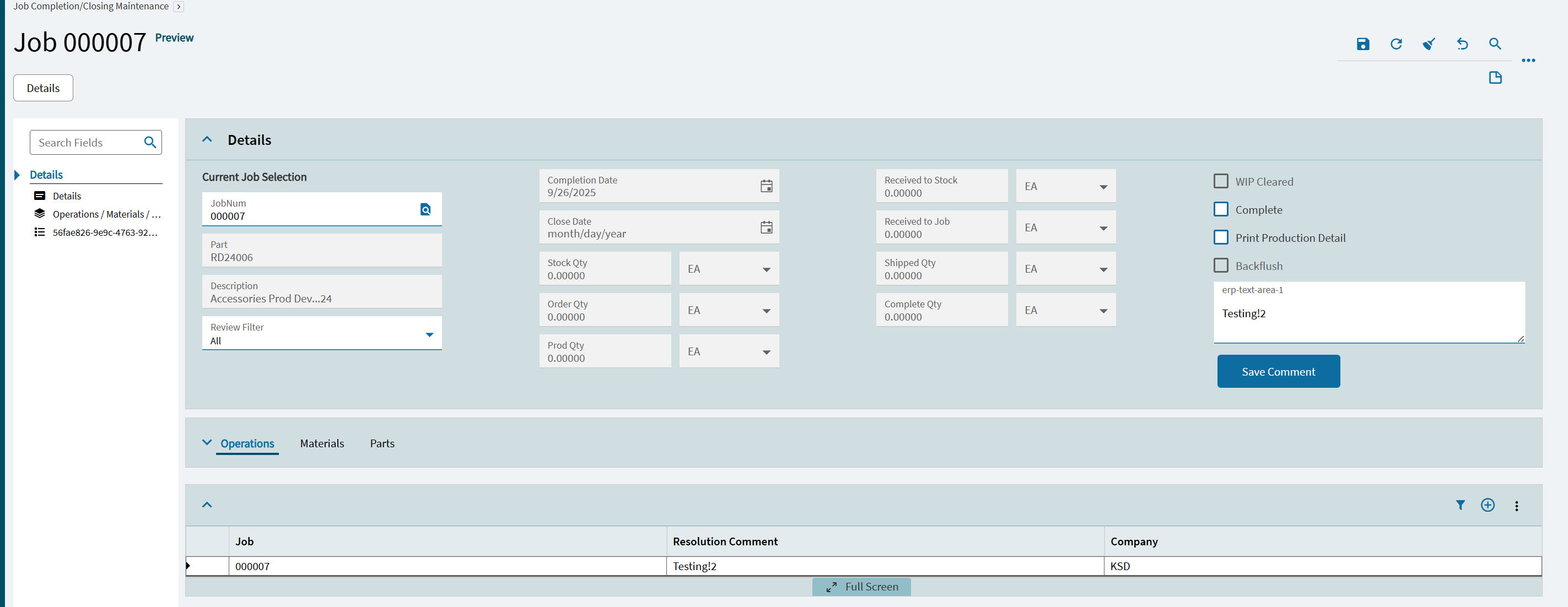

A little refresher ..
Added a comments field and a UBAQ grid to the Job Closing form.
The BAQ has been tested in BAQ Studio and that part works fine.
However even though I’m not getting any errors the data is not being updated in App Studio.

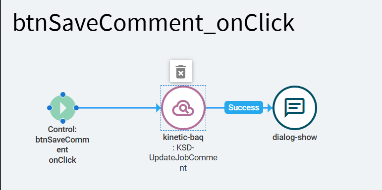

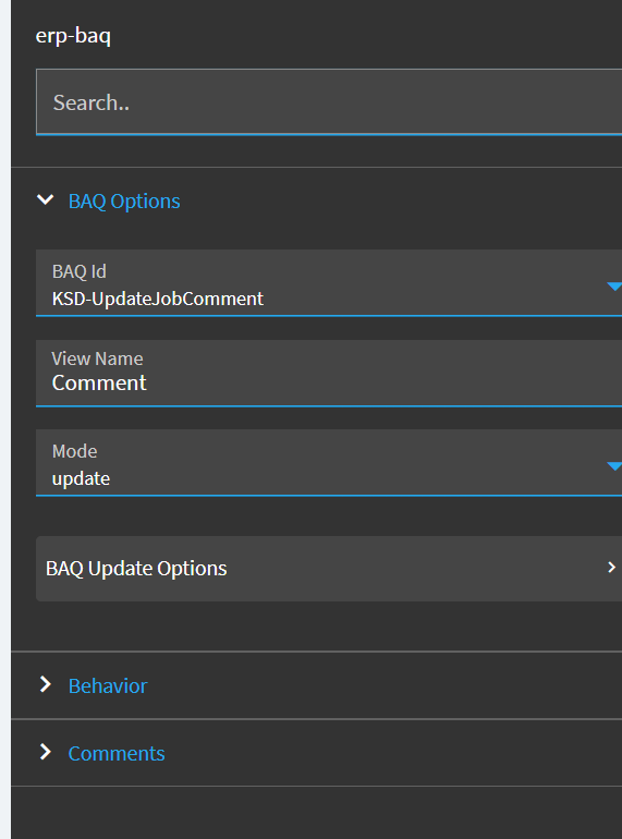

Button Action
When testing via Chrome I can see the BAQ get called just fine
But I get an empty (but successful response)
Any other ideas?
Are you just updating the native Job Comments field from the JobHead? Is that not already part of the dataset that pulls the rest of the information, or is it not and that’s why you’re using a uBAQ?
Reason I ask, is because if it’s already part of the natively available dataset, you should be able to simply add it to your screen and when you click the page save icon it will write to that field, too.
I’m going to agree with @d_inman that this may be in the existing dataset and you don’t need a uBAQ to update it.
It’s unfortunately not part of the data set on jobclosing. Job Closing has its own little subset of the jobhead dataset.
Maybe try setting RowMod to “U”

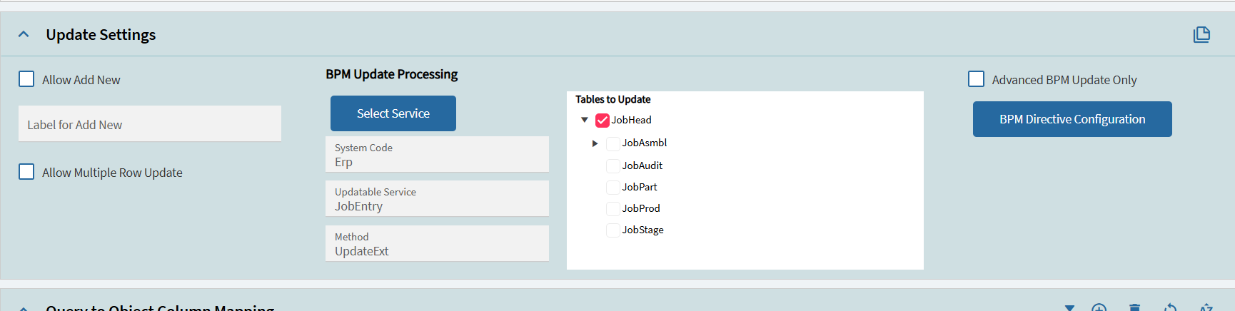

What method are you updating in the BAQ? Custom directive or base?
Try setting rowmod = U like JB said.
How would I go about doing that in App studio, I don’t think I’ve done that before

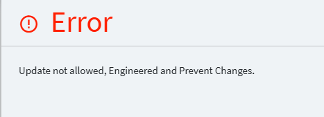

A new wrinkle, I used row-update to update that, however since these are looking at jobs in the rear-view I get this error trying to update commenttext on the jobhead
