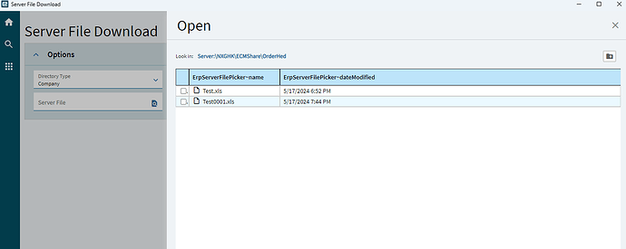

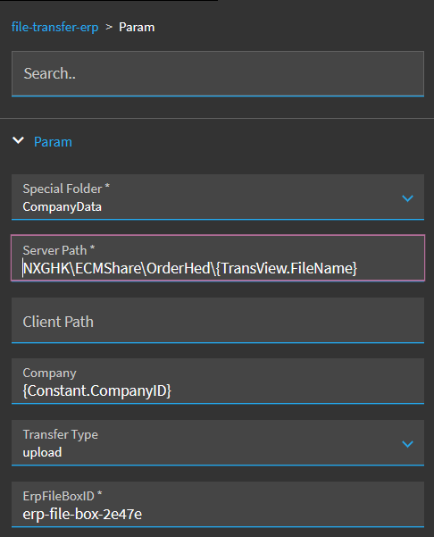

I am using this component to upload files to ECM but it is not working, is there something wrong with me?
Are you sure that path exists?
It will be [WhereverCompanyDataIs][YourPathAbove]
Your screenshot shows you have the file download widget configured in upload mode, not download.
And now you say function. You got me all confused.
Step back a bit, and explain everything.
I’m sorry for my explanation! I want to get the file selected by the user in the function, so after the user to the se uploadsrver, I want to get the file stream in the function.I want to implement a function similar to a paper clip attachment.

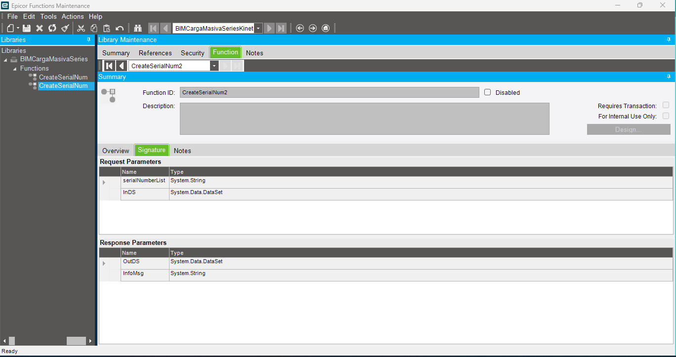

Hi @hmwillett
I’ve been working on the same form with exactly the same idea you mentioned in the post. I’ve even named my variables the same way. However, when receiving the response and assigning it to my DataView SerialNumberSelection, it doesn’t update with the information. Any idea what might be happening?
Function
