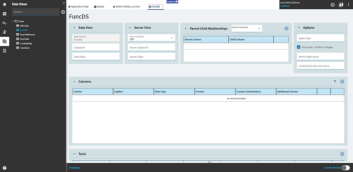

  1. Create a DataView holder
  1. Create a grid and bind it to the new DataView from Step 1.

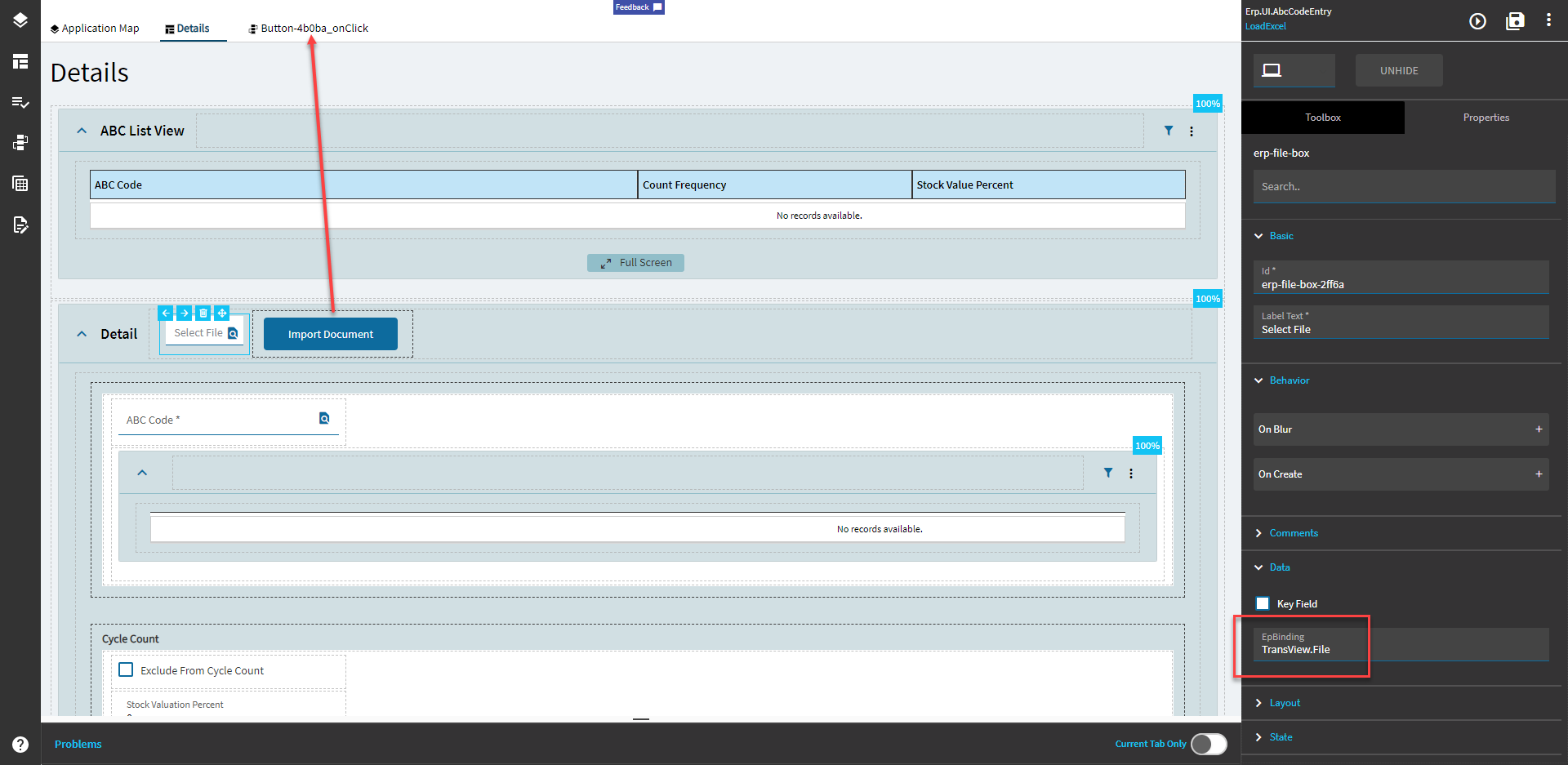

  1. Add the File Picker Client (or server) control to your form and bind it to something. I used TransView because it’s runtime and I don’t need to save the file after the fact.
  1. Add a button and create an OnClick event for it.

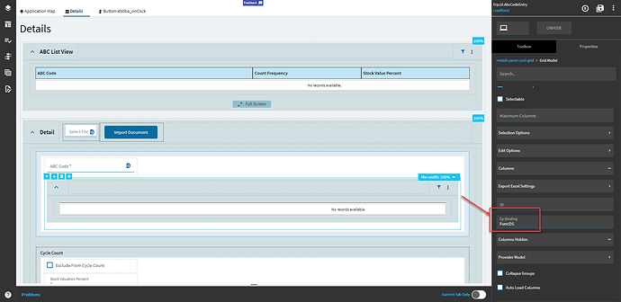

  2. In the OnClick event, add the file-transfer-erp widget. This will upload the file from your client to the server.
Special Folder - This will be the directory accessible to you on the server (yes, even you SaaSy folks!). I typically just use CompanyData
Server Path - If you want it at the root, just set it to the EpBinding that you set your File Picker to be (Mine is TransView.File) with the standard {} syntax. I’m adding an additional directory to mine called “Uploads”, but this is something only On Prem folks can do, I believe. Or else, you would need support to add it for you.
Client Path - Didn’t see a need for this.
Company - Optional, Company ID
Transfer Type - Upload to, well, upload!!
ErpFileBoxID - This is the ID from your File Picker Client control

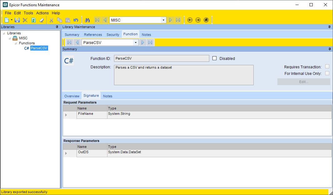

  1. Create and set up your function (If you use mine, you’ll need to edit it and change the server path)
    MISC2.efxb (2.5 KB)

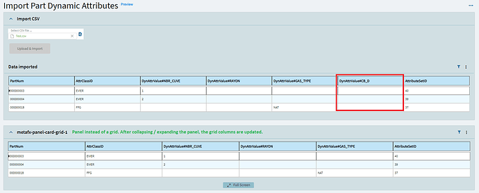

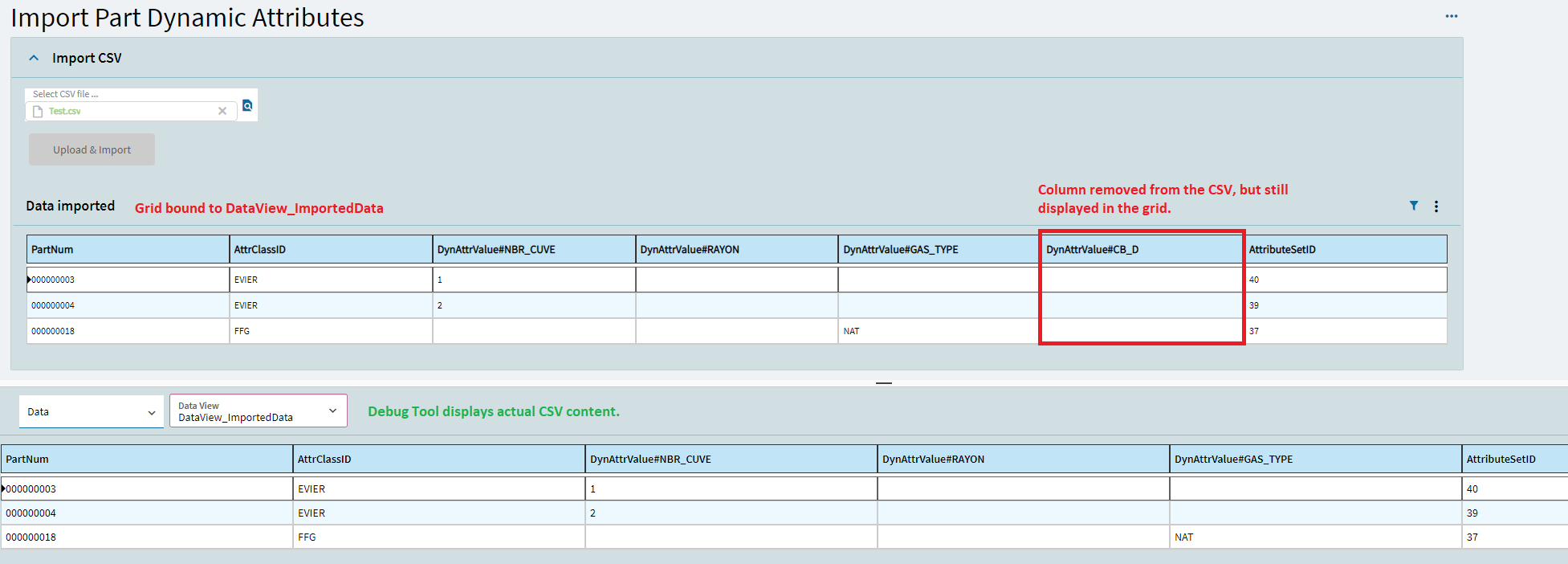

I have an issue regarding the refresh of the grid. If you :
  1. Upload a CSV;
  2. Add, edit, or delete columns in the CSV file;
  3. Reupload the CSV;
    ===> the Kinetic grid columns are not updated.
I clear the dataview using the dataview-clear widget when the upload button is clicked. Is there something else I could try?
I’m wondering if we could make a blank “template” dataset, and use dataview-copy to overwrite
it.
Poke it and let us know :slight_smile:
I played with the dataview-copy widget. Same issue. I appreciate the suggestion!
What’s strange is that the Debug Tool work as intended.
For example, I uploaded a CSV. I removed a column from the CSV file, then reuploaded it. The grid still displays the removed column, but the Debug Tool did remove the column.
I’ll have to look into that.
The Debug Tool is a nice addition. It still forget about it sometimes and use the CTRL+ATL+V command to display the DataViews in the browser Developer Tools console.
Just found out that expanding / collapsing a panel does refresh the columns. It would be great if I could just find the event to trigger that grid refresh.
I may end up triggering a collapse / expand of the Import CSV panel after the import is done. Not an ideal solution though! :slight_smile:
