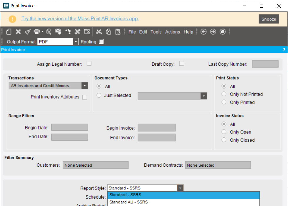

We’ve created a custom AR Invoice Form (Sales Invoice Report) using BAQ Report Designer. Is it possible to add it under Report Style dropdown field when printing AR Invoice as shown below? Or is there other way to do it?
I don’t know if that’s possible, but you could try manually adding a new report style.
Go to Report Style maintenance, open the ARForm report, add a new report style. Then you’ll need to specify the location of your custom report, the data definition, etc. in the prompt.
To get the correct info, I would first open your BAQ report in the Report Style menu, and copy all of those values for reference.

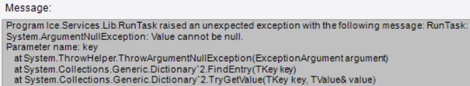

Thanks for your response. I tried your suggestion and I’m getting an error when I try to print it using the new style.

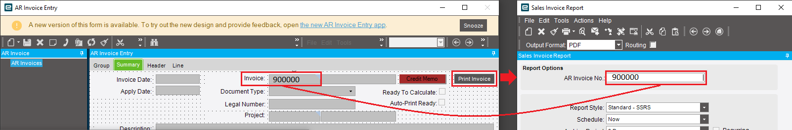

Anyways, I think it’s better to just create a Print button on the Summary page of AR Invoice Entry/Tracker and call the BAQ Report Designer from there.

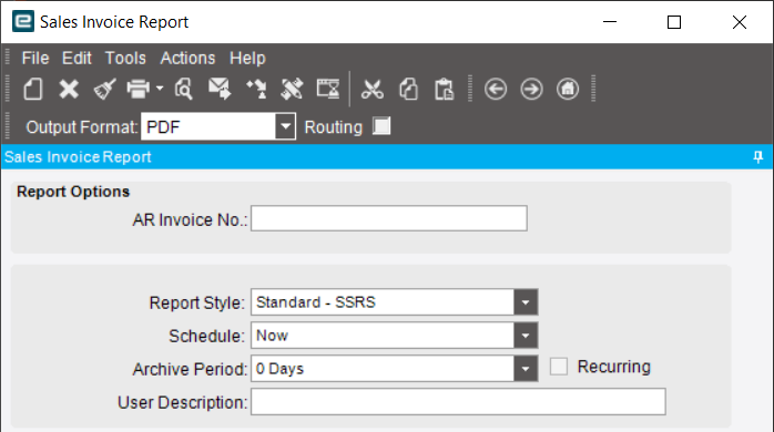

We were using a duplicate of ARForm RDD and its Report Style, however, we are encountering issues when there are updates in the system. Also, when we added some info, it’s duplicating the line items. That’s why we’ve decided to not use RDD and create our own report using BAQ Report. We’ve already created, tested and implemented it in Live, we just need to tag it in AR Invoice Entry/Tracker. I thought there’s a way to include it in the Report Style so all printable reports will be in just one place, but it’s not working because our BAQ Report is using an Option Field to get which AR Invoice No. the user wants print.

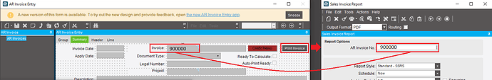

Now, I need help on how to call the BAQ Report when clicking the Print button as shown below. Then whatever is the AR Invoice No., it should automatically displayed in the Sales Invoice Report (BAQ Report).
