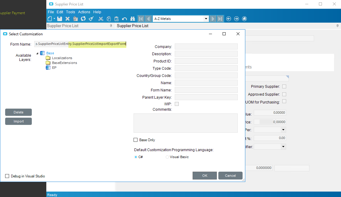

I’m trying to load SupplierPriceListImportExport form from a dashboard. I tried using processcaller launchform but I’m getting error message that .dll can not found. I looked at the dll in Just decompile and it seems like Epicor calls an internal method to load the form.
Can anyone one please suggest if there is a way to call this form from other entry screens on button click?
Currently, I tried using following code:
ProcessCaller.LaunchForm(this.oTrans, “Erp.UI.SupplierPriceListImportExportForm”, lfo);
