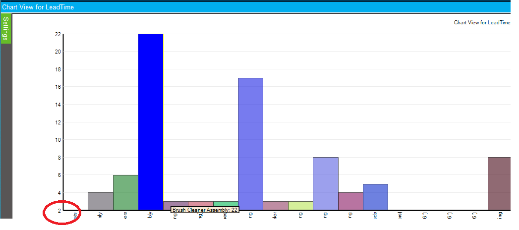

Hi everyone, how can we make chart view to start at value 0?
Below attached, starting at value 2 and would like to start at 0.
I don’t think this is possible. The dashboard charting tool in Epicor is really limited.
Other options include:
Excel, Grafana, PowerBI, Epicor Data Discovery.
Good luck!
I was able to do this by adding a UNION subquery to my BAQ. My chart had the X axis as Month so I added a union where month would be 99 and the Y axis value set to 0.
This added an extra entry at the far left of my chart, which we ignore, and added a 0 entry on the Y axis.
