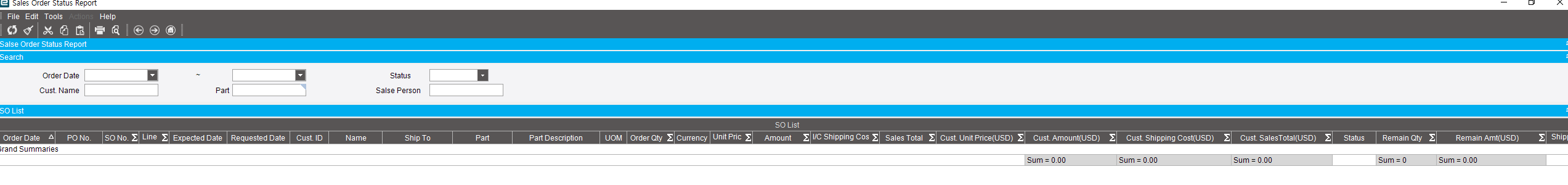

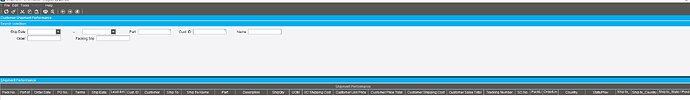

I have already created the 2 menus below using BAQ and Dashboard.(SO Stutus Report / Shipping List)
At first, we tried to put all the information in one menu, but we separated the menus for the following reasons.
  • Based on shipment, open order does not appear
  • When order and shipment are joined, the same number of order lines as the number of shipment lines appears in the report.(In case of split shipment)>> Order total is incorrect.
    So I ended up making these two reports into separate menus. However, since users are inconvenienced by the different entrances, I would like to recreate it as a tabbed section in one menu.
