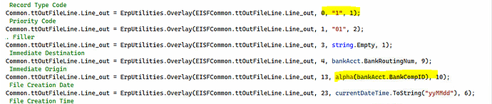

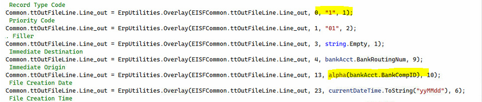

What is the format of the Nacha file created within epicor? I am having an issue that the bank is saying the first 2 lines values - one variable is filling 2 different values. so I am looking for a breakdown of the fields that make up the nacha file that epicor generates so I use 2 different variables for these 2 values. It is the company ID if anyone is curious for 2023.2 Kinetic.
What positions are they saying are wrong. line 1 14-23 Immediate Origin and line 5 41-50 Company Identification both have the ID field from bank entry in them. It is in the code in 2024.2 and 2121.2 and my bank has never had an issue.

From the EI file
Interesting yes that is exactly what kinetic 2023.2.31 is doing for me and where the value is coming from on the epicor screen. My bank is saying that first value you mentioned Greg P is not supposed to be the same value as line 5. But the value is supposed to be the Bank number that is 222222223 value. Thanks for your confirmation also Greg P. I am getting a meeting with my bank IT tech person now.
