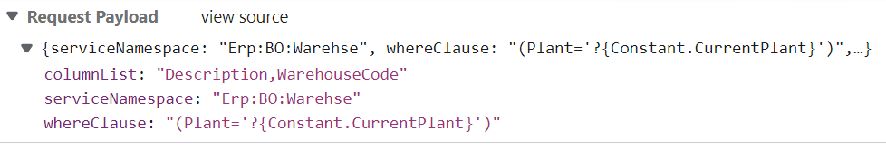

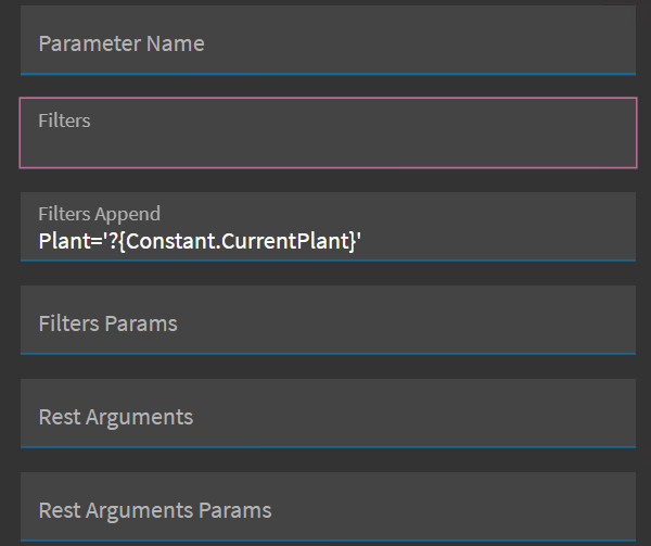

Configuration for one of my attempts is following:
and result:
Either I am receiving list of all warehouses (not filtered) or nothing because {Constant.CurrentPlant} is not translated correctly to string.

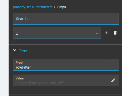

You can also create an event and set the rowFilter property of the combo. The value would be “‘{dataview.field}’”
