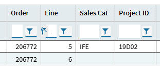

I was able to get it to update the two fields for only the added complement part lines, except it looks updated in the UI but they aren’t actually being written to the db.
(Where Line 5 is my new line and Line 6 is the selected complement part line, even after clicking the save button in the UI.)

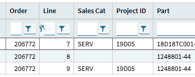

If I update my post-processing BPM to also set the ds.OrderDtl.RowMod = "U" then it duplicates my complement parts line: one with the values saved and one without.
