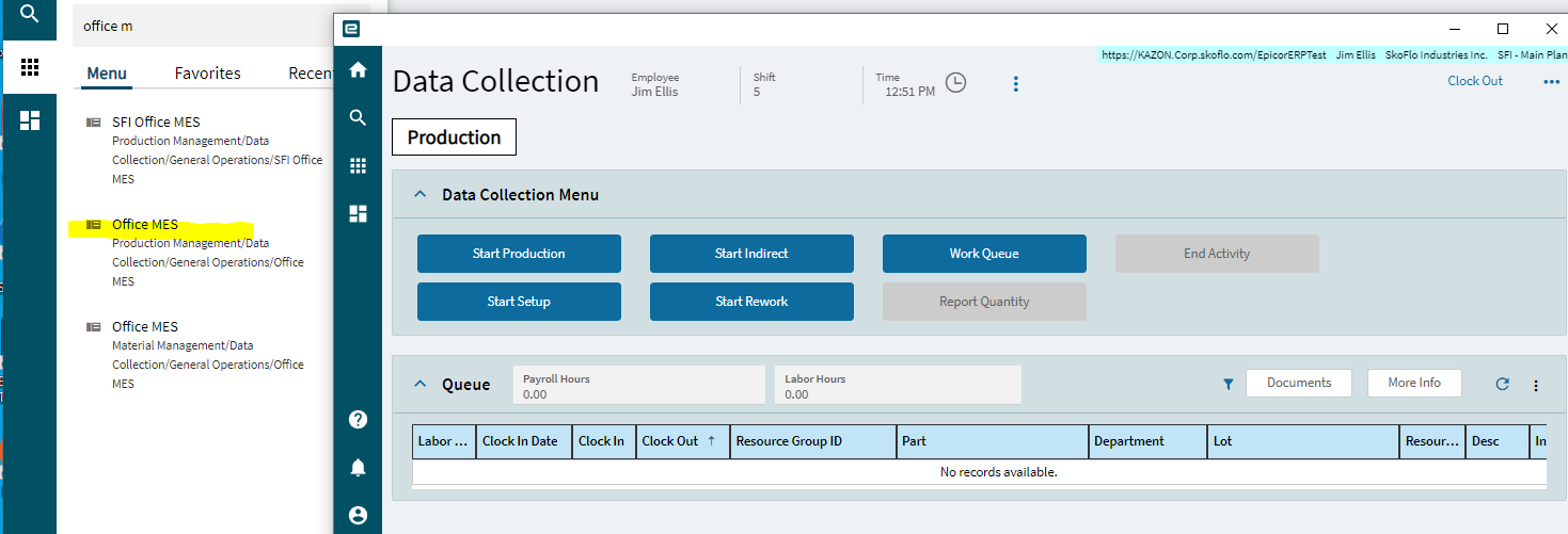

Here is a screenshot of the stock MES screen:

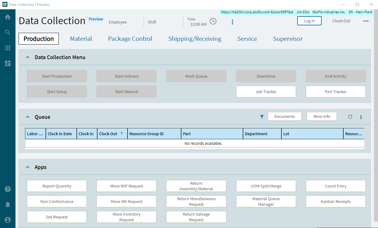

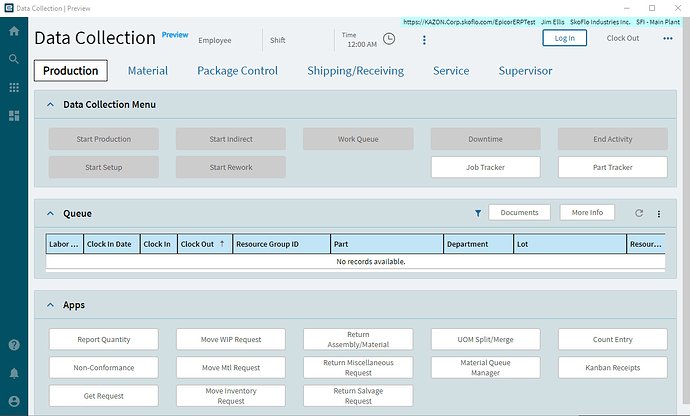

By contrast, here is a what the stock base-customization-layer of this exact same Office MES screen looks like when it is launched from app-studio. Please take notice of all of the additional controls, and the fact that the Employee is longer logged-in:
Please note that the above undesirable behavior persists even when Office MES customizations are added to the menu and launched from there.
I have tried hiding some of the extra controls to make the new layer more closely resemble the stock Office MES screen. While this has helped a bit, this has not solved the never-ending re-login issues for Employees who need to use the customized Office MES screen all day long.
