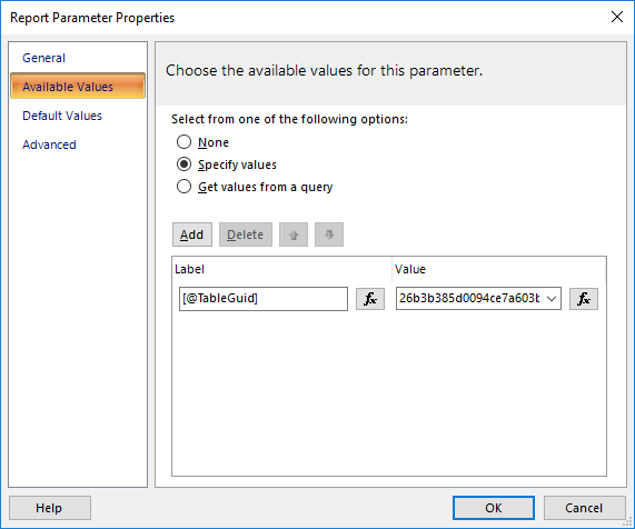

on trick I use is to set the parameters default value to the copy and pasted GUID. Just make sure to take it off when your done making your changes.

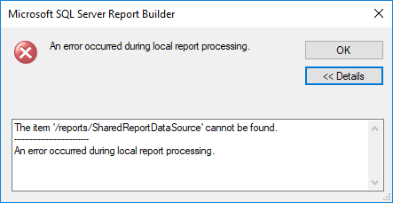

I know this is an older post, but i am trying to preview a ssrs report in report builder. I see the file name in system task but not sure where do i enter that to run the report?
i get an error when i try this?

Thanks Mazin but when i click run on the report, it goes straight to this error
any ideas? I copied the report style, then i downloaded the report and opened it with the report builder. I am working on my local workstation and not the server.
Jose
For any future reference, i had to put the report server url when opening the report builder. The educational videos in epic web says other wise. once you do that then the Table Guid option will show up when you click run report. Which you can retrieve from the system task monitor on the last column after report name.

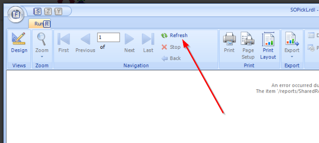

For some reports I get the same error. Clicking the Refresh button in the preview window seems to fix it. Note that it might clear out the GUID and you’ll have to re-enter it.
