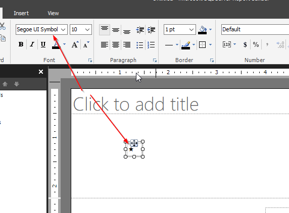

Most likely, the initial issue is that the font you are using doesnt have a character for that symbol.
Your font needs to be Segoe UI Symbol
Then it works fine

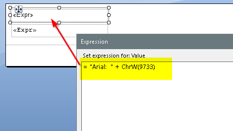

Have you tried the CharW function?
=   ChrW(9733) + "  This Line has a star!"
Edit
fixed function name and entered unicode value as decimal
Gives you the “square” when you run it.

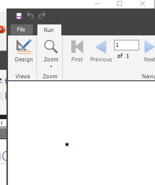

But switching to Print Layout shows
One last thing … There is an issue where the rendered document will display the star, but if you copy and paste that text to another document, it loses it.
