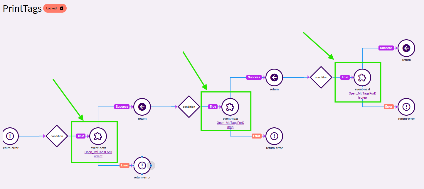

In your End Labor Activity app… you need to look at the PrintTags event. There are (3) separate calls to print tags, depending on whether you’re printing tags for Current, Scrap, and/or Discrepency (non-conformance).
Depending on what “Print Tags” button you select on the form, it is going to choose one of the (3) different paths. But, I’ll go down the normal “Print Tags” button… “Current”.

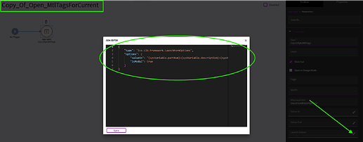

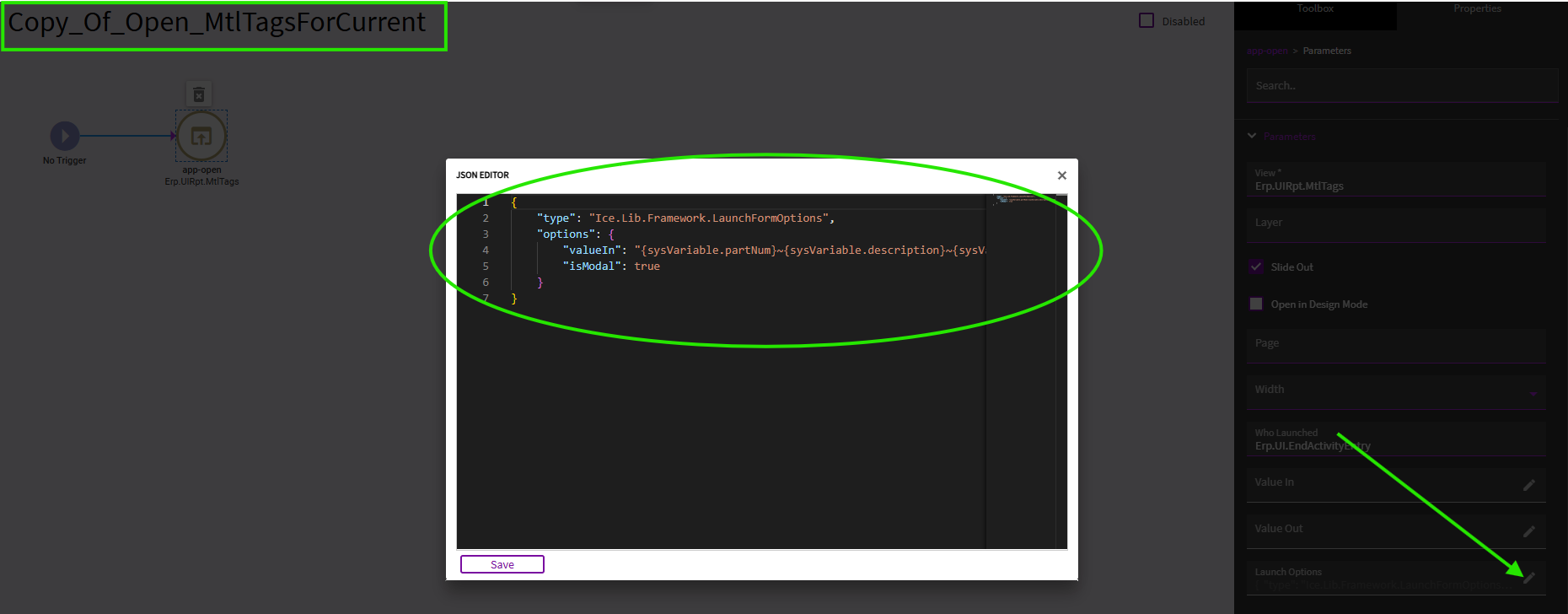

In the events panel, you’ll need to search for this event, right-click and make a copy.
With your new copy of that event… we need to edit the Launch Options of the app-open action.
It is already pass a LOT of various values to pre-populate the Material Tags. We need to inject your LaborDtl.InsLot_c into the values being passed in the app open:
Here is the full JSON expression that should work for you (assuming I got your binding correct):

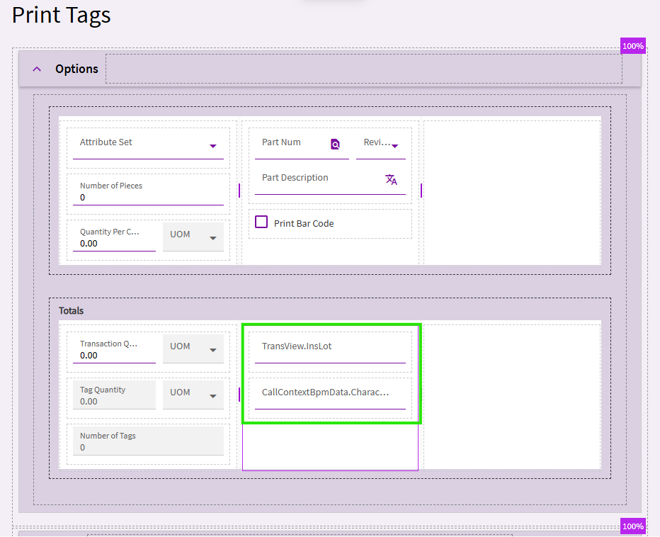

I added (2) textboxes to the form so I could see when things worked correctly.
The top is bound to TransView.InsLot
The second is bound to CallContextBpmData.Character01

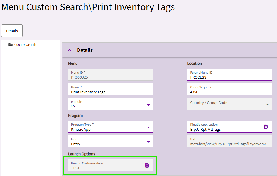

Save… publish… ADD this custom PrintTag layer to your Print Inventory Tags menu
Menu Maintenance… search for Erp.UI.Rpt.MtlTags.. add your custom layer to the menu.
Save the new menu change.

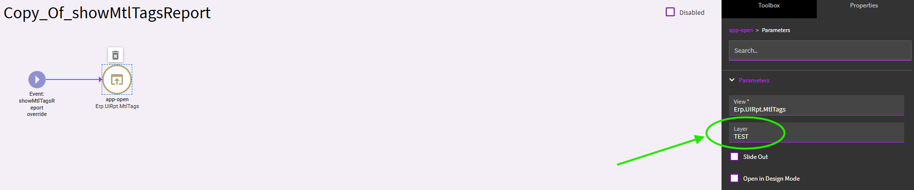

At this point we set up End Activity to pass a new value when it open the Print Tags app. We created a new custom layer on Print Tags to receive that value. BUT… we need to go BACK to the End Activity app. We need to tell the app-open event there to open Print Tags WITH our newly created PrintTags layer applied!
So, back in End Activity… add the PrintTags layer you just created.

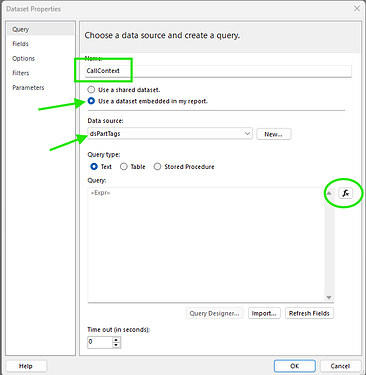

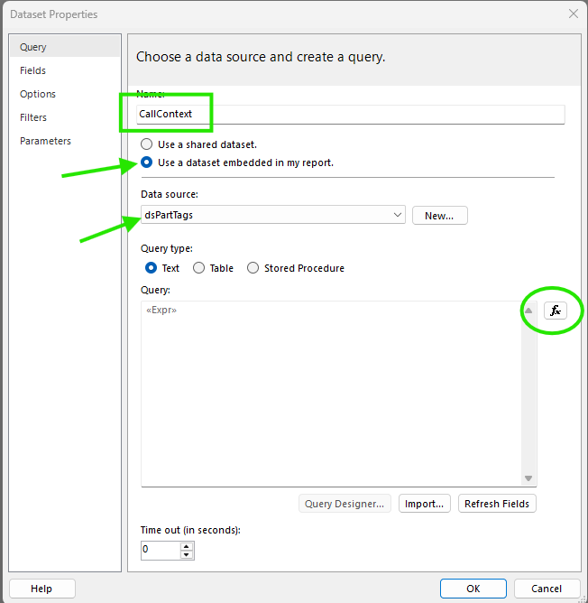

We’re going to add a new Dataset entirely.
Right-click the Datasets folder and select Add Dataset…
Give it a name… I used CallContext
Select the option to use a dataset embedded in my report… select dsPartTags
Then Click into the expression…
Expression:
