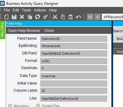

I’m actually able to see this in field help (classic)… but only sometimes :person_shrugging:

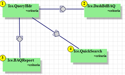

Not sure how far you got with this Nate, but for those who do happen upon this thread, two of the other tables used in the Where Used tab of the BAQ Designer are Ice.QuickSearch and Ice.BAQReport.
What I’ve done is this:
DashBdBAQ is linked via QueryID = QueryID, QuickSearch and BAQReport are both linked by QueryID = ExportID. Select all from QueryHdr in each case. Criteria on each table is SystemFlag = 0. I can’t find any BAQs that are used in BAQ List and Report List, so I can’t use Field Help and find the tables for the remaining two. If anybody knows, please do add them.
This is a purely BAQ approach and it won’t find any customizations, BPMs, and etc. that call the BAQ, you’d have to use the SQL approach Doug provided (which I’ve never done, sorry).
