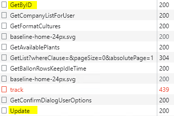

Have you performed an update to one user within the Epicor UI, and traced it to see what calls are made? You can do it all in Chrome, login to Epicor, make the change whilst looking at the Network tab in Dev Tools (Press F12 to open).

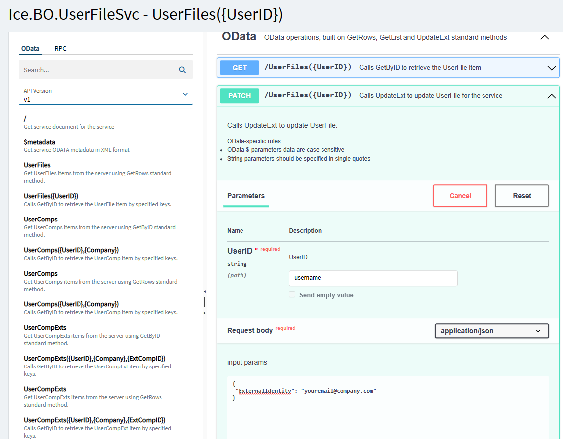

You can use PATCH UserFiles({UserID})
/api/v1/Ice.BO.UserFileSvc/Ice.BO.UserFileSvc/UserFiles(epicor)
witt payload like
“ExternalIdentity”: “youremail@company.com”

Ah right - that isn’t the actual trace of the methods - that’s just where it turned on the tracing!
I did it in the browser, and there are a few calls - some of which are just populating the screen. You can probably get away with the ones I’ve highlighted:
OR even easier is the way that @Olga showed with a patch.
