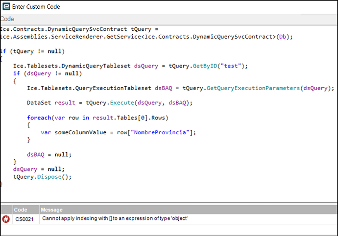

I have the following code that performs the execution of a BAQ.
However, I don’t know how I could extract the results obtained from the query.
Ice.Contracts.DynamicQuerySvcContract tQuery = Ice.Assemblies.ServiceRenderer.GetService<Ice.Contracts.DynamicQuerySvcContract>(Db);
if (tQuery != null)
    Ice.Tablesets.DynamicQueryTableset dsQuery = tQuery.GetByID("test");
    if (dsQuery != null)
        Ice.Tablesets.QueryExecutionTableset dsBAQ = tQuery.GetQueryExecutionParameters(dsQuery);
        DataSet result = tQuery.Execute(dsQuery, dsBAQ);
        //Read rows?
        dsBAQ = null;
    dsQuery = null;
    tQuery.Dispose();
foreach(var row in result.Tables[0].Rows)
    var someColumnValue = row["ColumnName"];
etc
What are you trying to do?
I have to extract the information from the query to insert it in some fields.
But I am having the problem when extracting the values from the query.
Message: CS0021 Cannot apply indexing with [] to an expression of type ‘object’
try : foreach(DataRow row in result.Tables[0].Rows)
The problem was solved.
