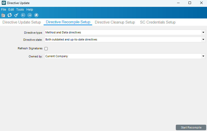

@brettstutzman, Like Kevin said, it SHOULD happen in the conversion, but if it doesn’t, Directive Update will do it:
