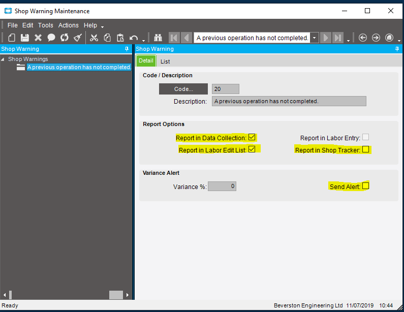

-in my opinion- i do not think that you need to check all previous operations you only need to check the last previous operation, and there is a standard shop warning you can set, to alert operators (labors) and send emails, however if you need to stop the labour transaction then pre-process BPM on EndActivity adding a custom code (foreach loop) to find and validate the last previous operation and raise an exception.
