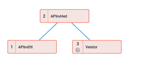

these are the fields and tables I have in my BAQ

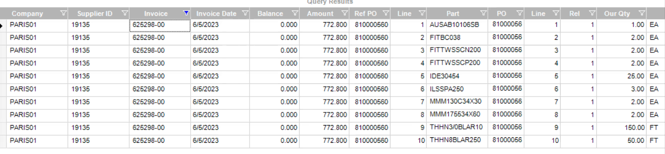

Unless I’m misunderstanding completely, the issue is the BAQ is pulling in APInvHed amounts/balances with every APInvDtl line…thus duplicating the amounts charged or open…so you can’t just sum them up.
Ex: invoice 1 has 10 lines…header total $10 and open balance is $2.
BAQ results, if summarized, yields 10x$10 = $100 total, $20 open.
You can do that with partition results. Depends on the use case and what the end result is.
I built out Linda’s BAQ - maybe this will illustrate her duplication issue…filtered on one multiline invoice…same header amount appears on every detail line.
