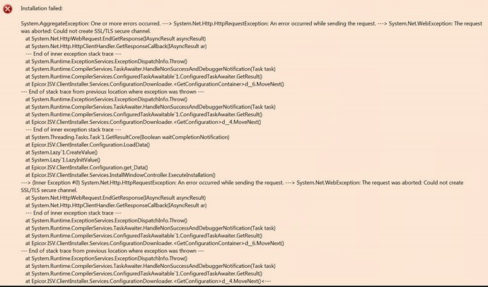

I get this message when trying to install Epicor client on user’s machine.
This may have something to do with the certificates being valid on the server. But we are using the serverless" version of Epircor.
We do not have Epicor installed on our server. We use the cloud based applications where we install the clients from “https://download.epicorsaas.com/”
There is only one system that has this issue, it is Windows 7 and it is updated.
