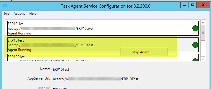

Where do we go to restart the task agent for the Test environment? Is this done through the admin console? This is my first time trying to restart the task agent.
Update
I was able to work my way into the admin console and restart it. If this is correct?
Yep, that’s it.
You can also restart the “Epicor ICE Task Agent X.X.XXX.X” via services. That will impact all environments using the service however.
