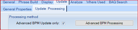

check your baq as updatable and on the update tab check advanced baq only.
click Advanced BPM processing. The bpm code will go on the post processing of GetList
The action is execute ABL code and you put your calculation code there. The message lines get written into the appserver log to help with debugging. I use a log viewer that can open the log while it is in use.
If you get stuck post a screenshot so someone can help you.
