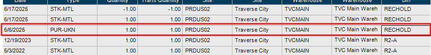

Open the receipt, then the receipt line, set received qty to zero.
This will make a PUR-UKN with minus in Parttran.
Then you can delete the line and the receipt.
Lucky you you do not have inspection for it (then you cannot reverse the receipt).
