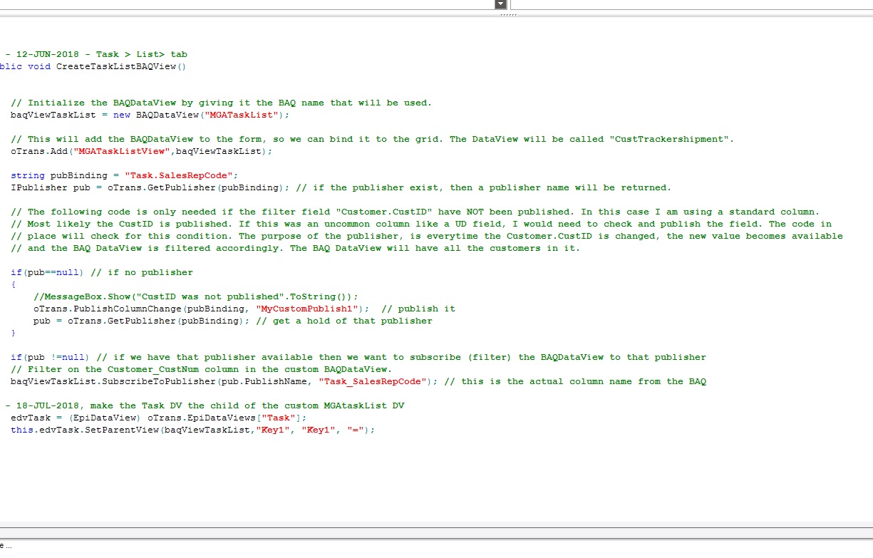

public void CreateTaskListBAQView()
	// Initialize the BAQDataView by giving it the BAQ name that will be used.
	baqViewTaskList = new BAQDataView("MGATaskList");
	// This will add the BAQDataView to the form, so we can bind it to the grid. The DataView will be called "CustTrackershipment".
	oTrans.Add("MGATaskListView",baqViewTaskList);
    string pubBinding = "Task.SalesRepCode";
	IPublisher pub = oTrans.GetPublisher(pubBinding); // if the publisher exist, then a publisher name will be returned.
	// The following code is only needed if the filter field "Customer.CustID" have NOT been published. In this case I am using a standard column.
    // Most likely the CustID is published. If this was an uncommon column like a UD field, I would need to check and publish the field. The code in
	// place will check for this condition. The purpose of the publisher, is everytime the Customer.CustID is changed, the new value becomes available
	// and the BAQ DataView is filtered accordingly. The BAQ DataView will have all the customers in it.
	if(pub==null) // if no publisher
		//MessageBox.Show("CustID was not published".ToString());
		oTrans.PublishColumnChange(pubBinding, "MyCustomPublish1");  // publish it
		pub = oTrans.GetPublisher(pubBinding); // get a hold of that publisher
	if(pub !=null) // if we have that publisher available then we want to subscribe (filter) the BAQDataView to that publisher
	// Filter on the Customer_CustNum column in the custom BAQDataView.
	baqViewTaskList.SubscribeToPublisher(pub.PublishName, "Task_SalesRepCode"); // this is the actual column name from the BAQ

// MGA - 18-JUL-2018, make the Task DV the child of the custom MGAtaskList DV. BAQ column name corrected for the parent DV.
edvTask = (EpiDataView) oTrans.EpiDataViews[“Task”];
his.edvTask.SetParentView(baqViewTaskList,“Task_Key1”, “Key1”, “=”);

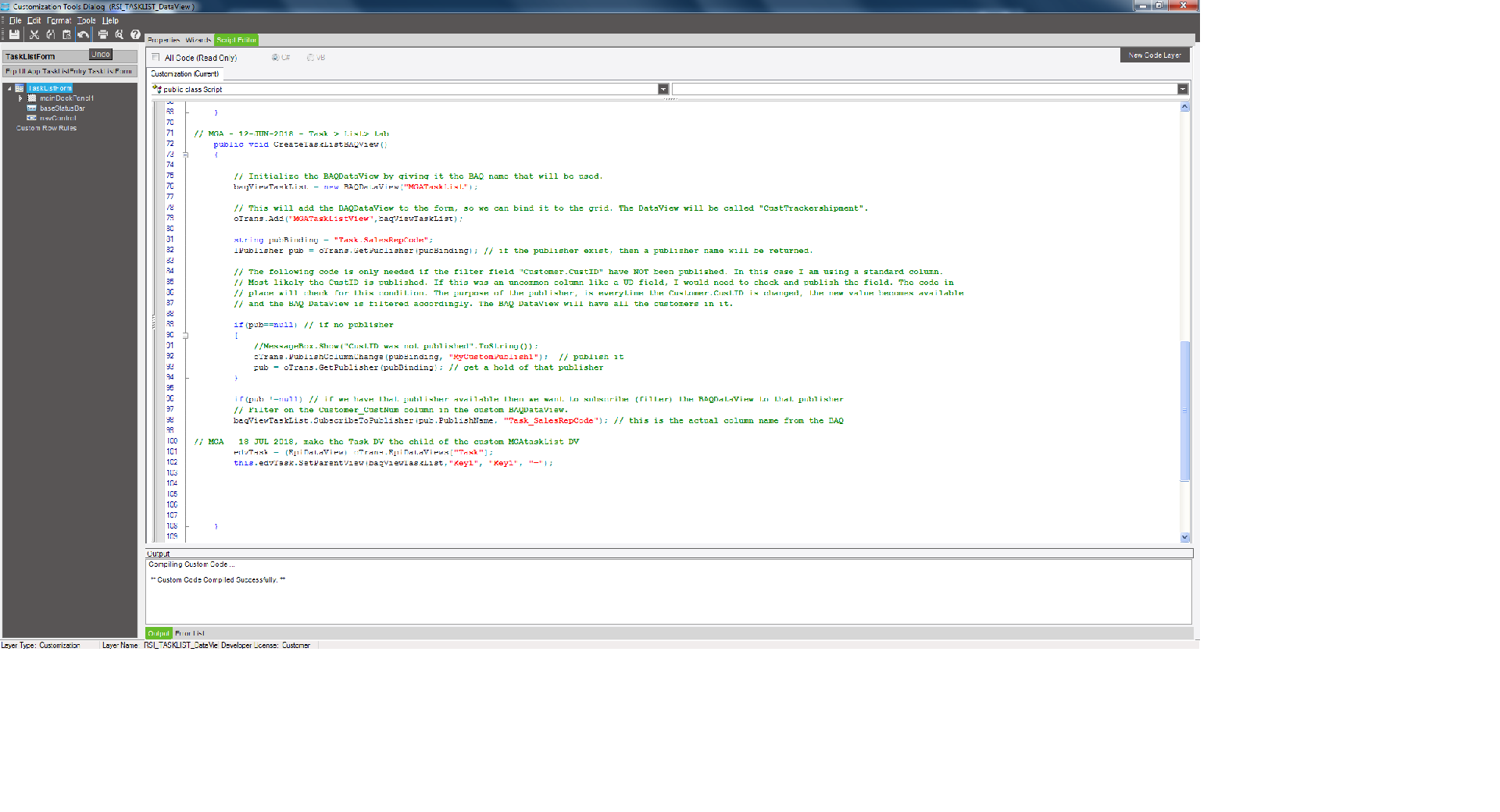

I used the following code:
// MGA - 12-JUN-2018 - Task > List> tab
	baqViewTaskList = new BAQDataView("MGATaskList-V2");
	oTrans.Add("MGATaskList",baqViewTaskList);
    //string pubBinding  = "Task.DueDate";  // this is the actual table name from the Task view.
    string pubBinding2 = "Task.SalesRepCode";  // this is the actual table name from the Task view.
	//IPublisher pub  = oTrans.GetPublisher(pubBinding); // if the publisher exist, then a publisher name will be returned.
    IPublisher pub2 = oTrans.GetPublisher(pubBinding2);
	//if(pub==null) // if no publisher
		//MessageBox.Show("if not null".ToString());
	//	oTrans.PublishColumnChange(pubBinding, "MyCustomPublish1");  // publish it
	//	pub = oTrans.GetPublisher(pubBinding); // get a hold of that publisher
	if (pub2==null)
		oTrans.PublishColumnChange(pubBinding2, "MyCustomPublish2");  // publish it
		pub2 = oTrans.GetPublisher(pubBinding2); // get a hold of that publisher
	// MessageBox.Show("before if pub != null".ToString());
	//if(pub !=null) // if we have that publisher available then we want to subscribe (filter) the BAQDataView to that publisher
	// Filter on Task_SalesRepCode.
	//baqViewTaskList.SubscribeToPublisher(pub.PublishName, "Task_DueDate"); // this is the actual column name from the BAQ
	if (pub2 != null)
    baqViewTaskList.SubscribeToPublisher(pub2.PublishName, "Task_SalesRepCode"); // this is the actual column name from the BAQ
this.edvTask.SetParentView(baqViewTaskList,“Task_Key1”, “Key1”, “=”);
//this.edvTask.SetParentView(baqViewTaskList,“Task_SalesRepCode”, “SalesRepCode”, “=”);
