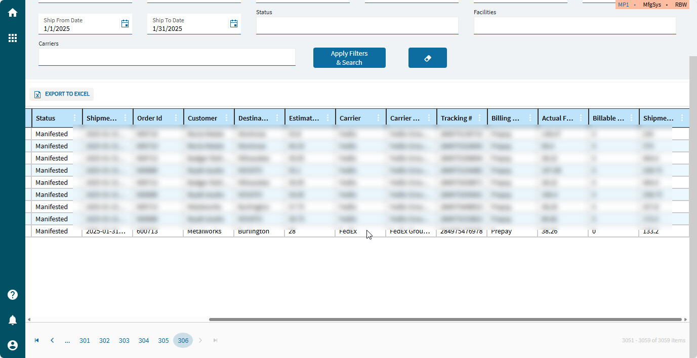

Take a look at the Shipment Summary Inquiry. You can run it by date, carrier, workstation, etc. It will return shipment data that you can export to Excel. Gives you a lot of information on each shipment including the estimated and actual freight cost. Can even save your grid layout.

Odd, I just did the month of Jan 2025 and have hundreds of records.
Yeah, we have thousands of records in QS. We ship everything through QS.
