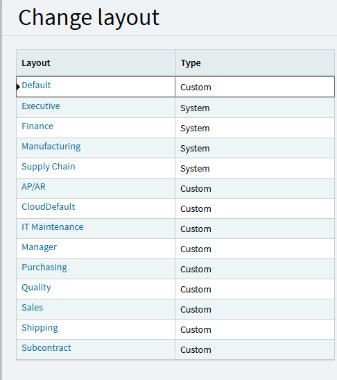

These layout names you speak of, I don’t recall when I edited a layout, of being able to set one. Can you show me?
When I click the … in the top right of the home page layout, I can change layouts, manage layouts, or edit layout. If I manage, I can create a new layout with a name. After its create, I can’t find a place to view/change the name besides this slideout.

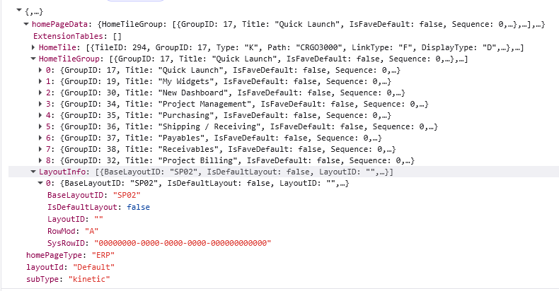

You can probably glean some schema info from the REST API Ice.BO.ShellLayoutSvc
Seems ‘ForUser’ methods might assume current user (no userid input) :person_shrugging:
but may give you some clues on the schema for your baq.
//POST: /GetPersonalShellLayoutForUser
  "homePageType": "ERP",
  "subType": "kinetic",
  "layoutId": "Default",
  "homePageData":{},
  "userOptionsData":{},
  "favoritesData":{}
For example:
It appears homePageData contains collections: HomeTileGroup (TABS) and HomeTile (tiles on tabs) and LayoutInfo (layoutID / name ?)
