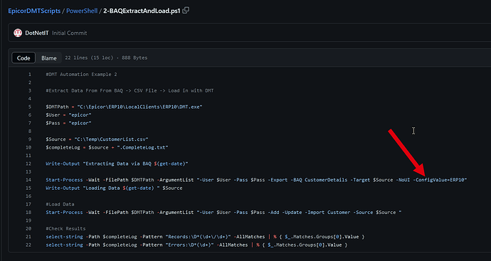

I haven’t tested it, but looking at the scripts on github, you might be able to specify which config file to use, which would set your proper database.

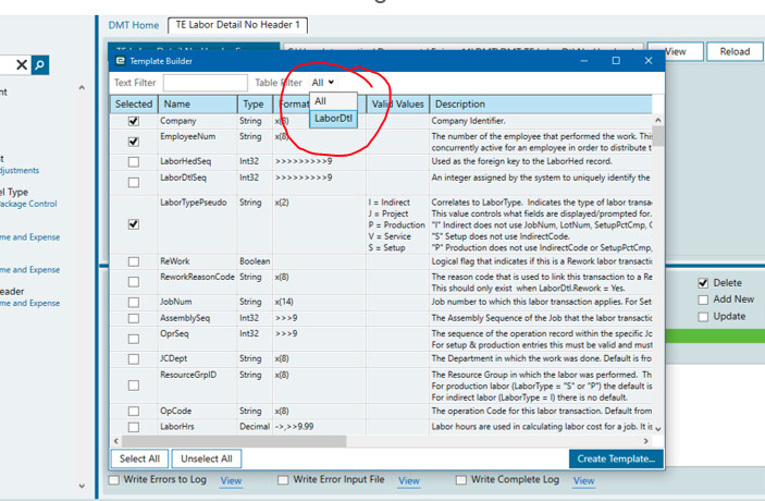

The table I created my template from is the LaborDtl table using DMT. Maybe I’m not calling the correct process.

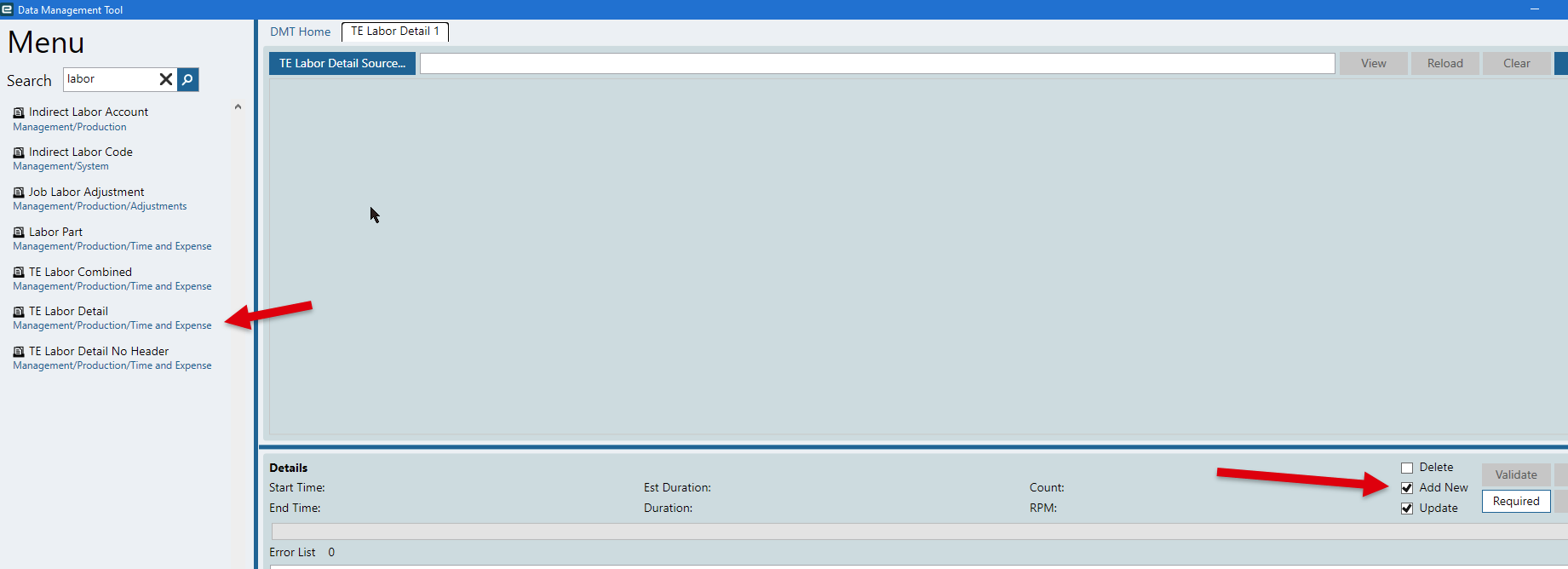

Do you need -add? In DMT if you don’t click add, it will only try to update record.
Also is looks like it’s called TE Labor Detail? How did you figure out the name would be Import LaborDTL?
I inferred that from the powershell examples on the Github site. Their sample code is
#DMT Automation Example 1
$DMTPath = "C:\Epicor\ERP10\LocalClients\ERP10\DMT.exe"
$User = "epicor"
$Pass = "epicor"
$Source = "C:\Temp\Product.csv"
#Load Data
Start-Process -Wait -FilePath $DMTPath -ArgumentList "-User $User -Pass $Pass -Delete **-Import Part** -Source $Source "
They have -Import Part so I inferred they were choosing the table to update so I choose the LaborDtl table from the DMT template builder.

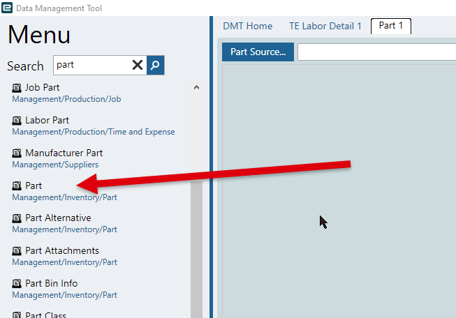

Part is the name of the DMT though, so I think it’s probably going to be name of the DMT. Because there are multiple DMT templates that can affect that table.

So I’ve changed my code to call for the DMT process TE Labor Detail. When I run the script in Powershell it returns an error “Cannot find TE”.
