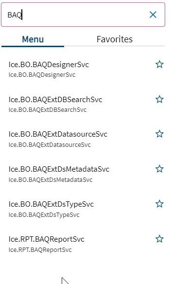

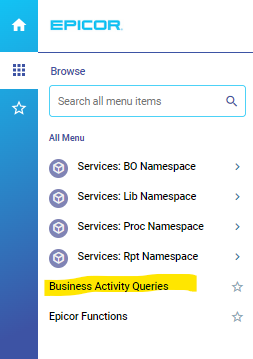

I don’t see BAQ SVC anywhere in Swagger
Could you please let me know how can I do this with BAQSvc?

On the Swagger Home page, it has its own section near the bottom. It is not with the BOs, PROCs, etc
