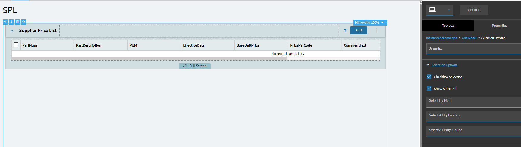

I figured some of it out. I’m making a grid in the purchase order menu to take the which populates with the PO lines so I can have a button to add it to the supplier price list.
Have the grid with select boxes.
On the button click do one of these.
Then in another event do one of these.
Then use that data set from the selected to update VendPart table.
