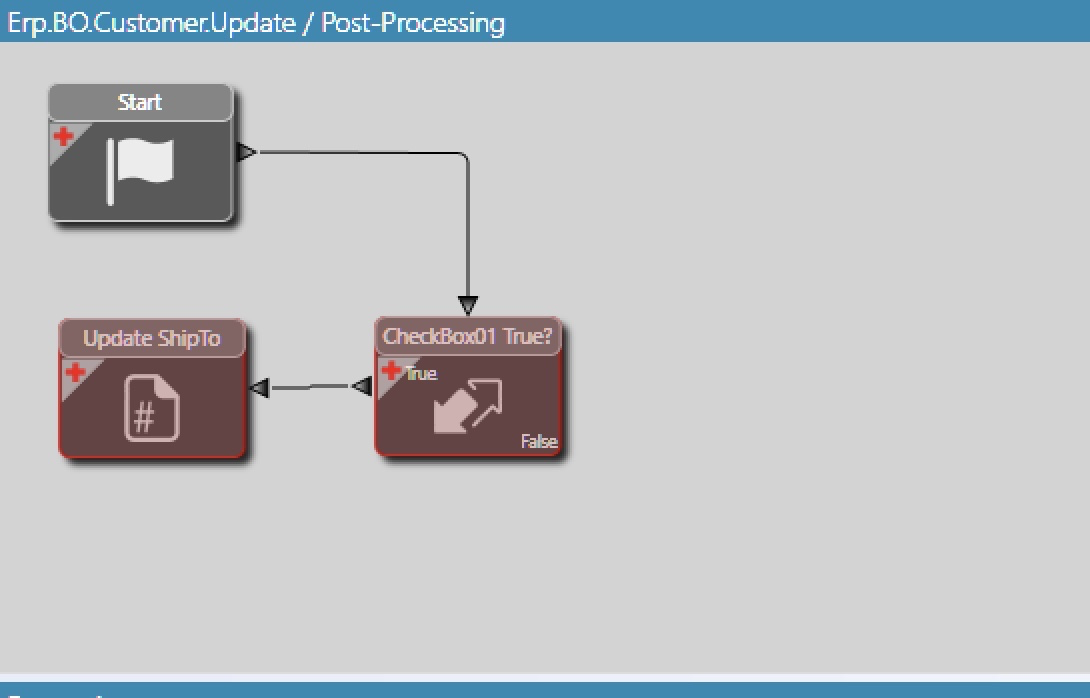

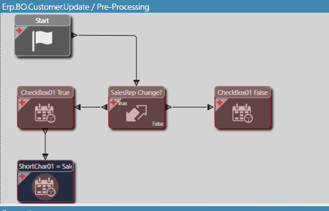

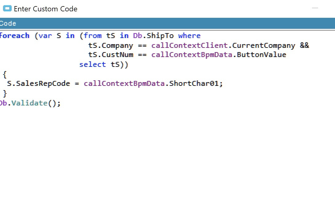

The datasets in BPMs only contain the records that were actually modified, so ShipTo collection would be empty. What I would probably do is in PreProcessing, check the Customer to see if the SalesRep was changed and set a callContextBpmData field accordly. Then in PostProcessing, check to see if that field is set, and go through the ShipTo records and update them. Something like this:

If I used the BPM to do it, I imagine it would happen in Preprocessing in the same place where you checked to see if it changed. Then if they say no, you don’t set the flag that says it changed.
If I used the customization, I’d be modifying callContextBpmData to store the values and the flag and not do the Preprocessing portion at all. Just to keep the code in one place.
