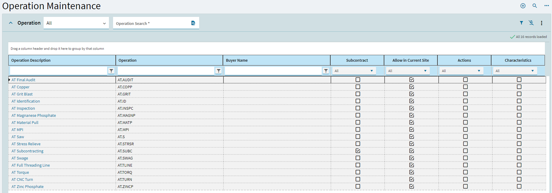

Hi everyone, I am trying to set the “Allow in Current Site” field in Operations to default to True. Was wondering what the best way to about this would be.

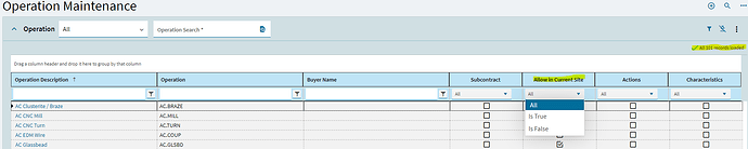

Currently, I have added the Static Filter AllowCurPlant = true as a customization under the LandingPage data view.

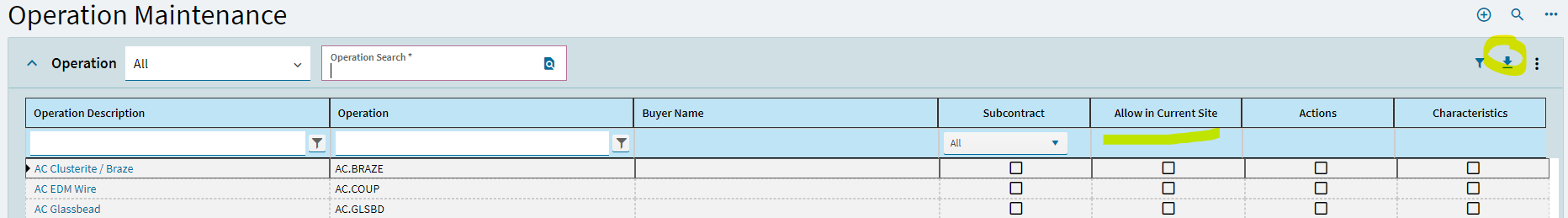

This works for most of our Sites except the one that is alphabetically last, because not all records are preloaded. Once I click the Download button to preload all records, then it works.

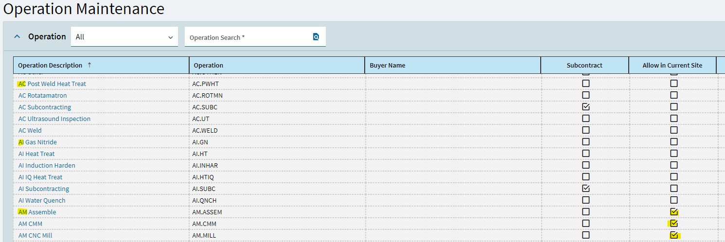

Thanks John! Sorry I should have clarified; I understand operations are not specific. We have them named so that each operation starts with a certain character for each site. I am more so looking for a way to default toggle the “Allow in Current Site” field on the landing page so that a user only sees their own operations.

Yes I am trying to default the filter so that only the ones that have the scheduling requirement for the current site (and therefore flagged by the system as “allowed in current site”) appear. We have named our operations with site specific prefixes (AM., AC. etc) to tell them apart.
