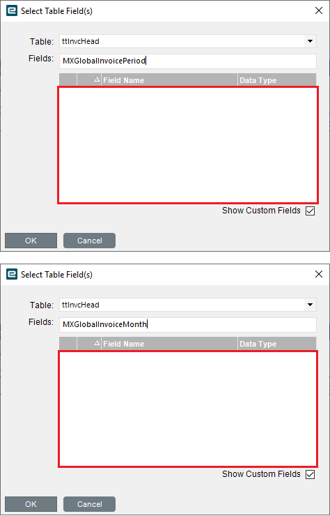

Normally this problems could be soved using Set Field Widget whithin BPM Data Directive, but both of there is missing in ttInvcHead:
Looking at SQL database I saw that MXGlobalInvoiceMonth and MXGlobalInvoicePeriod currently are stored in [Ice].[PatchFld] table, Is ther a way to insert record in this table? i mean workaround?, because testing the BO.PatchFldImpl.UpdateExt method returns a “Creation of PatchFld not allowed”.

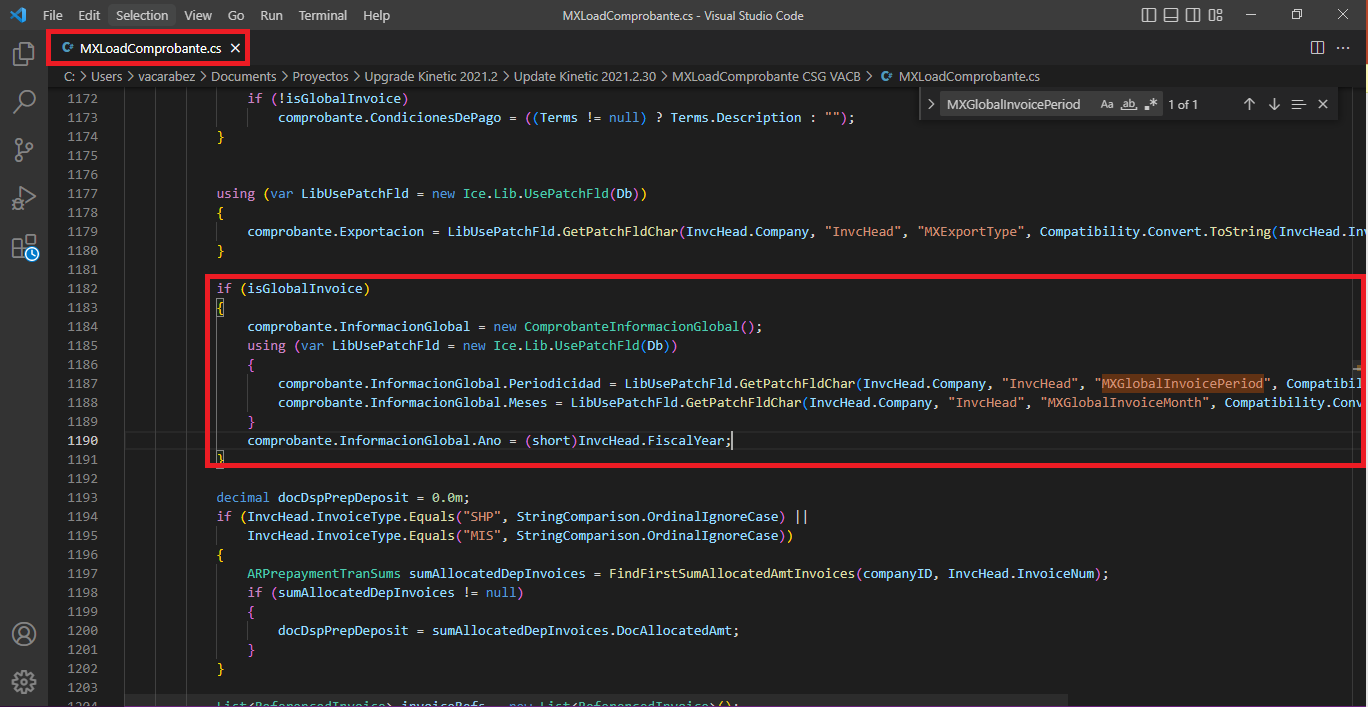

Making the change that you suggest would implicate modify this lines in this MXLoadComprobante.cs file, which is in charge of sending the invoice data to the PAC. But you helped me a lot since this process should not involve generating a global invoice, I think that these fields should not be sent to the PAC according to the Tax Authority (SAT) rules.
Es relacionado a Anexo 20, Factura No Global a Publico en General, pero generada desde la Orden de Venta (Counter Sales), creo que esos dos campos no deberian solicitarse para timbrar la factura, debe ser un problema de configuración.

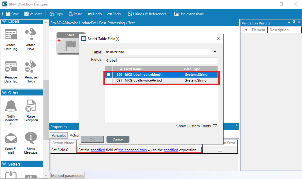

Si puedes saber el número de factura creada en el Post Processing de ProcessCounterSale puedes intentar algo como lo siguiente (usado en el post processing de ARInvoiceSvc.GerShipments):
Esta interesante el ejemplo que proporcionaste, lo voy a revisar, aunque si pudiera utilizar una BPM Post-Procesing utilizaria directamente el wigdet Set Field:
