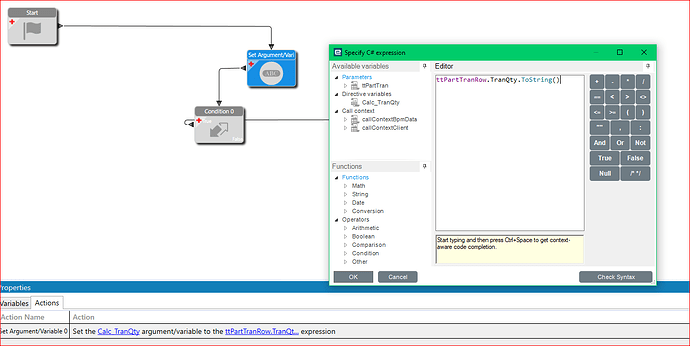

TranQty is a decimal field and it cannot be compared with a string expression.
Create a variable for string, use “Set Argument/Variable” widget to set tran qty value to this string
And put this condition:
This should help!
Hi, thanks for your reply. In this case, I have the expression set as 1 (and not “1”) - wouldn’t this been seen as an integer and not a string value?
If I convert TranQty to a string value, then I am not sure if the ‘greater than’ condition will work, when comparing this number to my expression.
