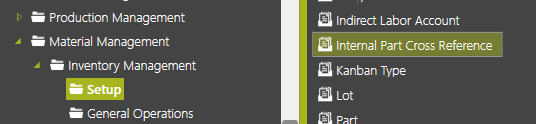

It’s a separate program under Material Management > Inventory Management > Setup > Internal Part Cross Reference

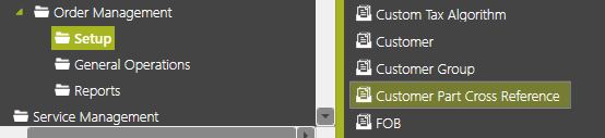

Customer Part Cross Reference is for when the Customer has their own part number and for whatever reason you have a DIFFERENT part number for the exact same item. I use this one a lot.

@DermotN, you’ll want to use Customer Part Cross Reference to tie your stock part number to your customer’s internal part number…
