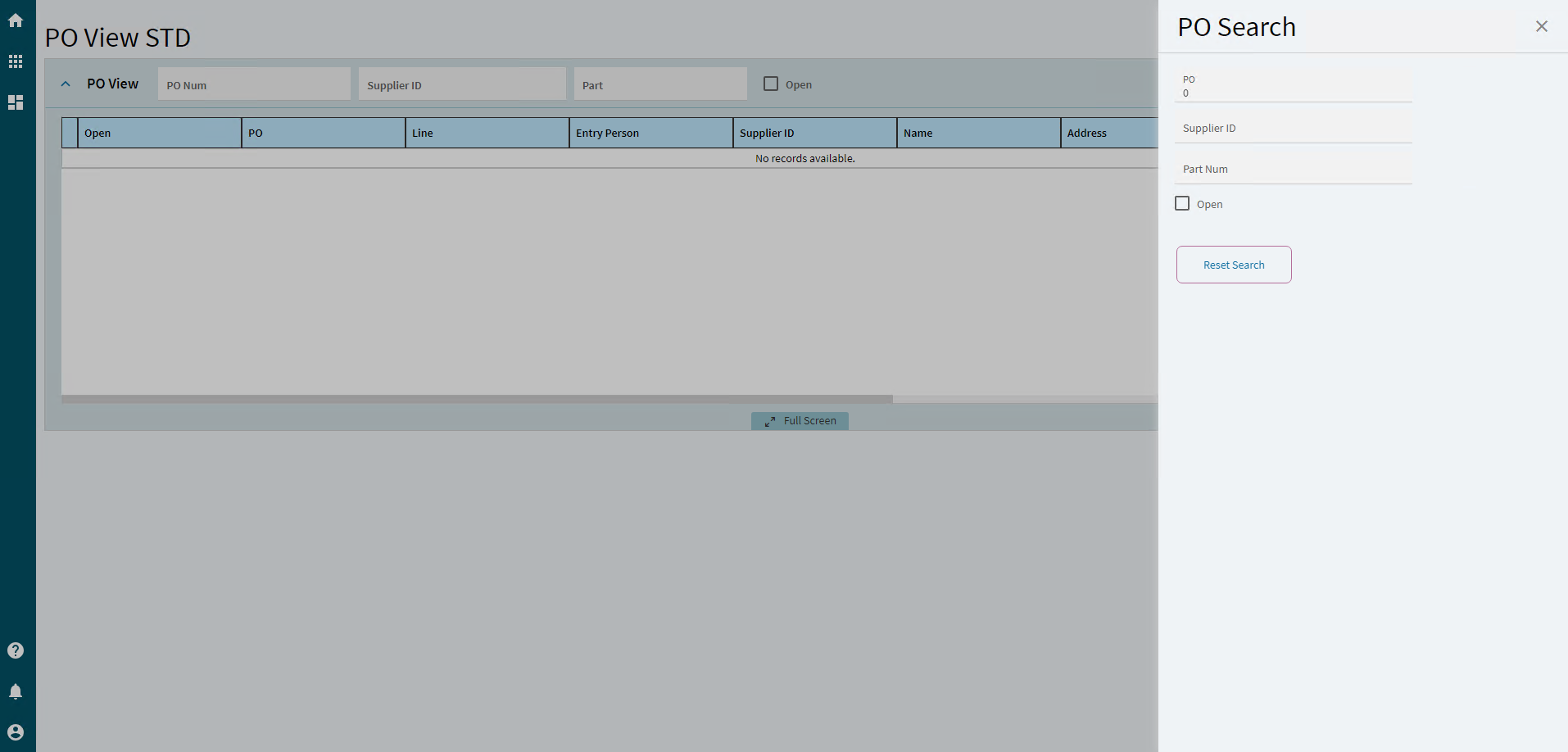

I’m currently working with a dashboard in Epicor Kinetic, and I’ve noticed that the slider for the dashboard filter loads automatically every time the dashboard is accessed. I would like to prevent this slider from loading automatically and only activate it when needed. Is there a way to configure the dashboard settings or customize the filter behavior to achieve this?
Attached is a screenshot for reference.

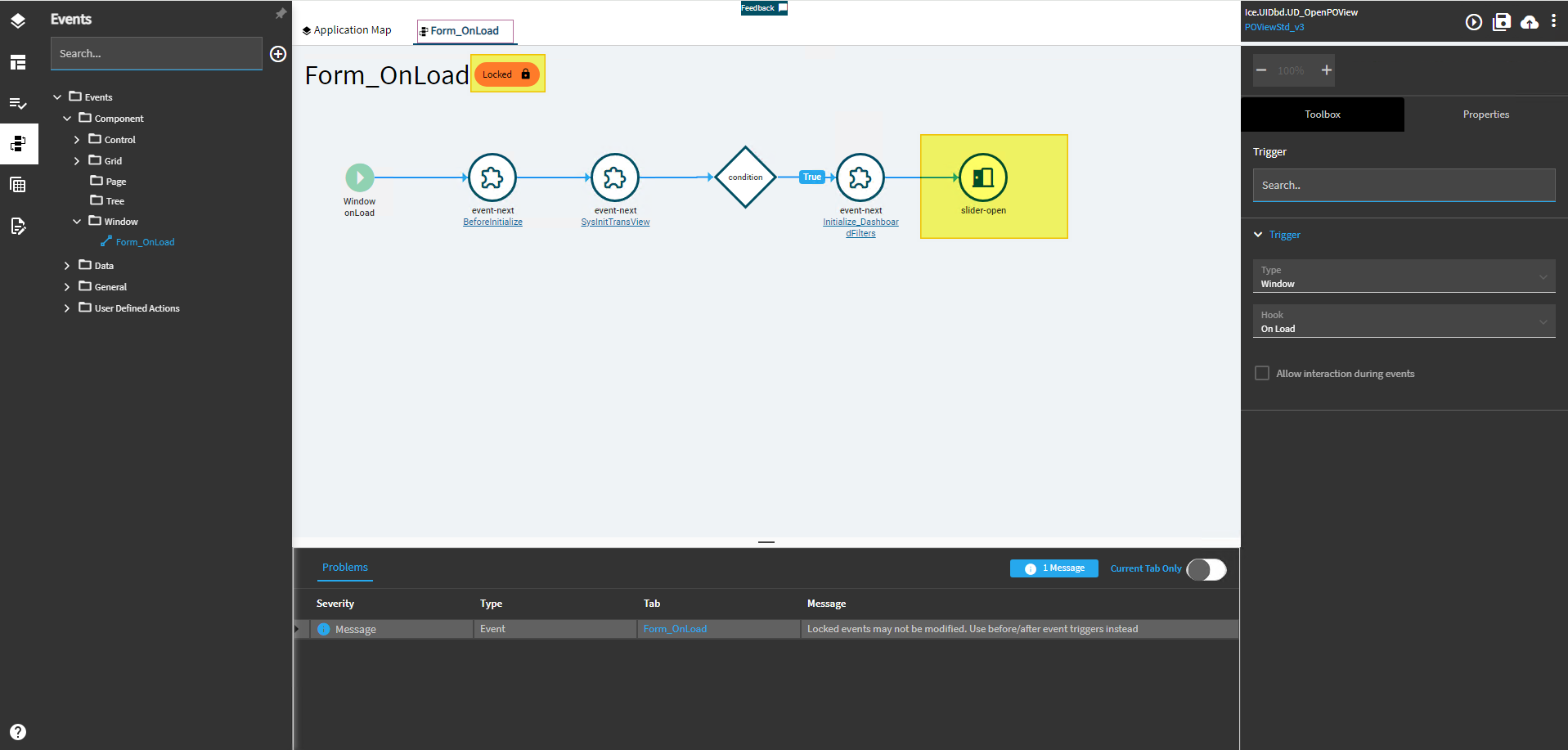

I have to assume there is an event in your dashboard to open that slider. Did you create, or can you find any events in your dashboard that includes the “slider-open” action?
It could be that the event is being triggered when the dashboard loads. If you can find the event, you can repoint the trigger to something else, like a button click.
Yes there is an event “Form_OnLoad” but it is an system event therefore it’s locked and cannot be modified. :slightly_smiling_face:
Cool… you found it. if you want to stop that behavior, then you’ll need to create your OWN Form_OnLoad event.
Right-click on the event in the tree view and select “Copy”.
This will create an editable version. Delete the slider-open action.

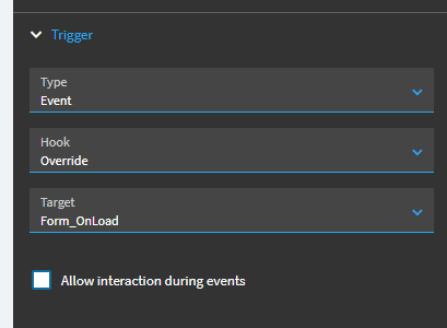

Then on the trigger of your new copy, you’ll want the below settings:
Now your new copy (without the slider-open) will “Override” the stock Form_OnLoad event.
